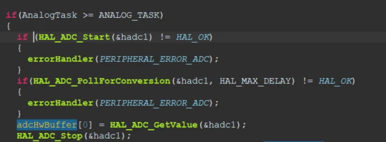

Aug 21, 2024 7:36 AM UTC
@STTwo-32
I went through the example. But I was not able to see the IOC configuration and the driver files. Instead of the approach given in the example, I used ADC Polling method
In this approach I'm getting HAL_ERROR in the HAL_ADC_PollForConversion
