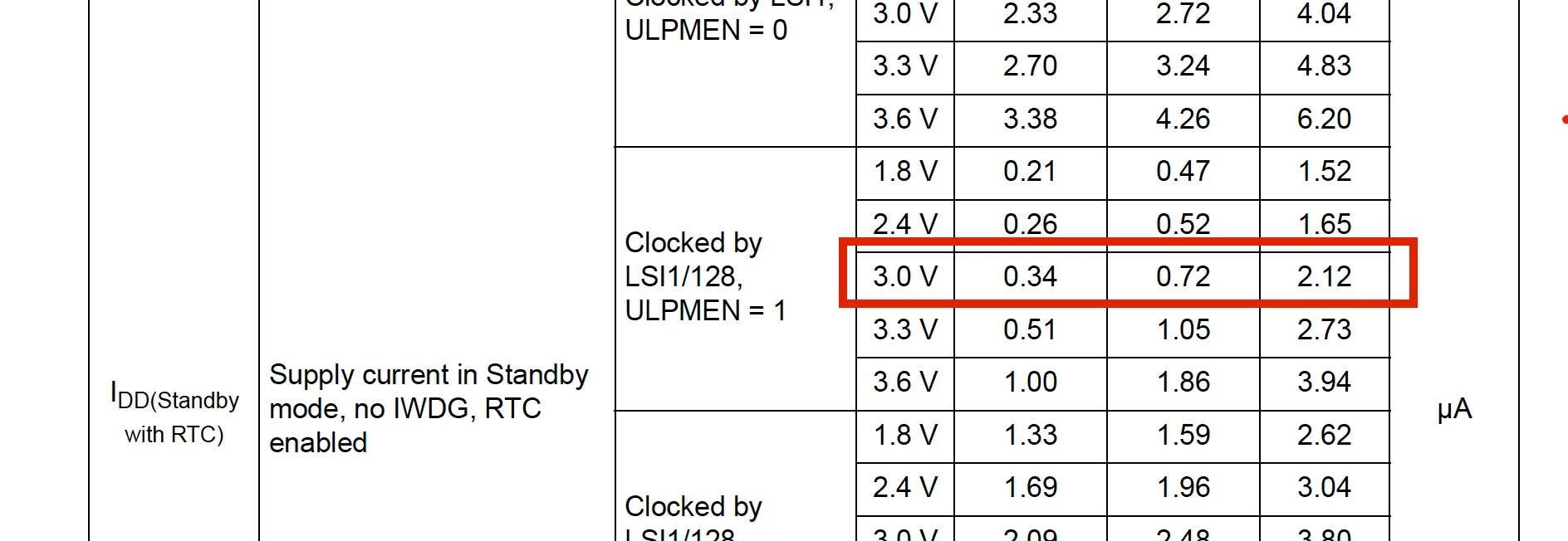

I enabled two active tampering loops (TAMP_IN1 - TAMP_OUT5 and TAMP_IN6 - TAMP_OUT4) in standby and the measured current is around ~0.35uA, which is something similar to what is mentioned in datasheet for "standby with RTC".
I would like to know whether this behavior is expected when active tamper is enabled? Since TAMP is part of the RTC, I understand that the full RTC module is enabled.
Does this also depend on how many active tamper loops are enabled because I can see similar current irrespective of one or two loops are enabled?
