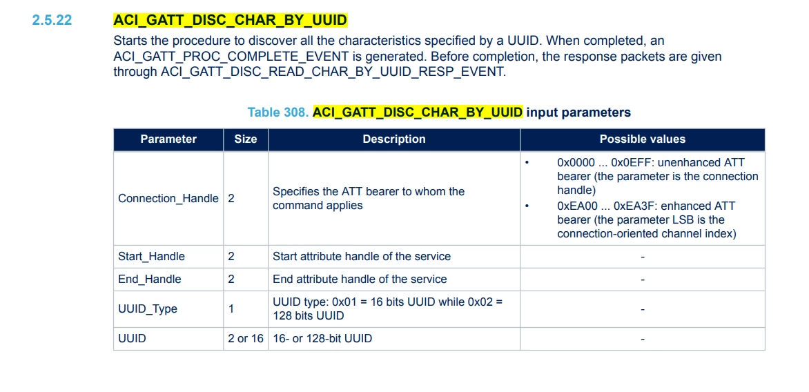

ACI_GATT_DISC_CHAR_BY_UUID with eror 0x92
  • September 14, 2023
  • 2002 views
Can't make it work any restrictions on the values? attribute handler or UUID?

DS.4
DS.4Author
Senior
November 13, 2023
I use the command and get -error , what values do the fields support, must be entering something incorrectly or command doesn't work....
