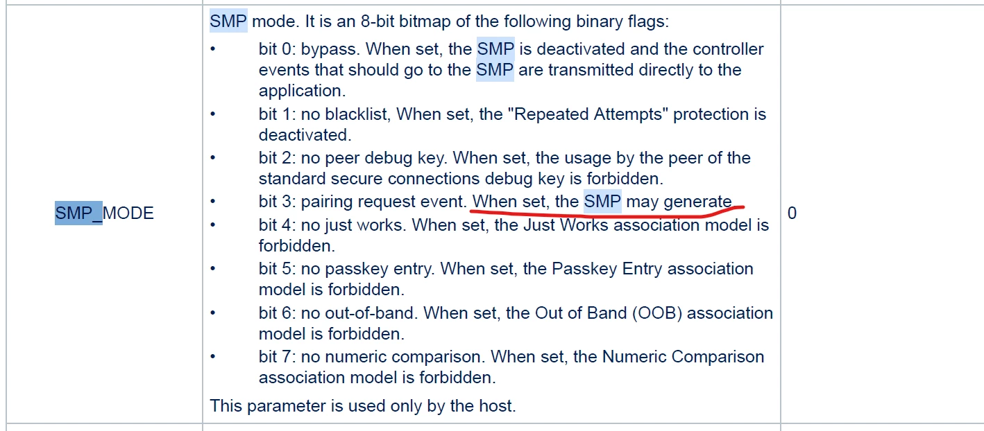

I am using STM32WB55 chip on my custom setup. I have configured my device in peripheral mode. I want to be able to accept / reject pairing requests initiated by the client device. I am following AN5270 for development. I have added code to set bit3 in SMP_MODE register to enable the generation of pairing request event. Although, the documentation says "SMP MAY generate the event". Why is that?
The documentation also says that if I bypass the SMP, all the events that go to SMP will be transmitted to the application. However, what are the other events handled by SMP? I am not able to find a list of events handled by SMP. Is there any other documentation that I am missing?

I resolved the issue. Turns out I was using a very old firmware version for Bluetooth. Updating to latest firmware solved the issue immediately.
