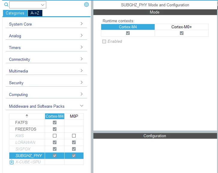

Hi.
I am using STM32WL55 for FSK communication.
Firmware version is STM32Cube_FW_WL_V1.3.0.
In the past, version 1.1.0 was used, but version 1.3.0 has changed a lot.
So I'm not sure how to set it up.
​First of all, I want to set SUBGHZ_PHY, but the Enable check box is disabled as follows.
_legacyfs_online_stmicro_images_0693W00000bhpvMQAQ.pngAnd files related to SUBGHZ_PHY and Radio are not visible after [Generate Code].
Could you let me know why it is disabled and how I can use it?​
Please give me a procedure or method on how to set up and use FSK.
Thank you.​

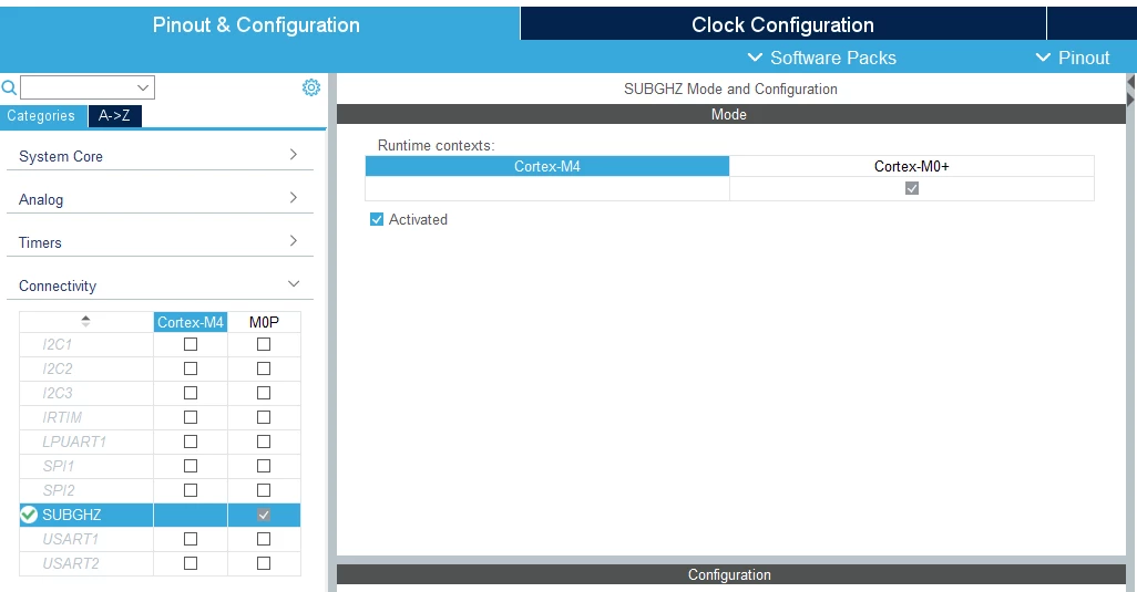

Hello @SOn, Dong-Seong​ ,
Make sure that you are using the latest version of STM32CubeMX 6.8.0 .
If I select the SUBGHZ peripheral under the Connectivity category, I can check the box next to Activated.
Foued
Son, Dong-Seong
Apr 11, 2023 8:56 AM UTC
Hi.
It is SUBGHZ​_PHY in Middleware and Software, not in Connectivity.
I want to enable SUBGHZ_PHY in Middleware and Software

Hello ,
For the SUBGHZ​_PHY in Middleware and Software :
For dual core you need to Activate the IPCC and the SUBGHZ.
Foued
Son, Dong-Seong
Apr 11, 2023 10:41 AM UTC
Oh
When I activated IPCC, I was able to enable SUBGHZ_PHY.
I resolved it
Thank you so much
