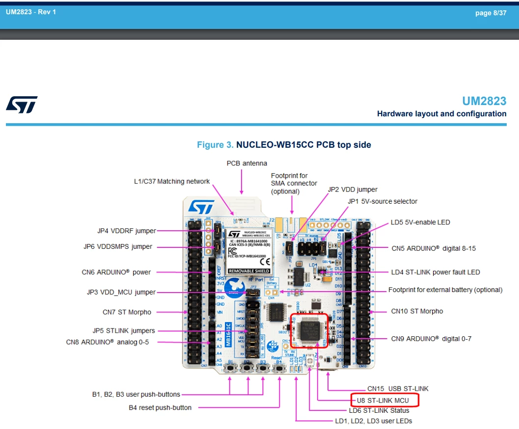

I've been doing some BLE development using STM32WB55RG mounted on Nucleo-68 board. Our end product is very space constrained & doesn't need all the headers, switches etc that the board provides.
So I took a loser look at what we could save space by removing & immediately noticed that there is a STM32F130CBT6 on the board. I take it this is dealing with the ST-Link?
I am relatively new to the STM32 eco-system so am aware that this my be a dumb question but, is it possible to still use ST-link without this & just use the STM32WB55 with ST-Link?

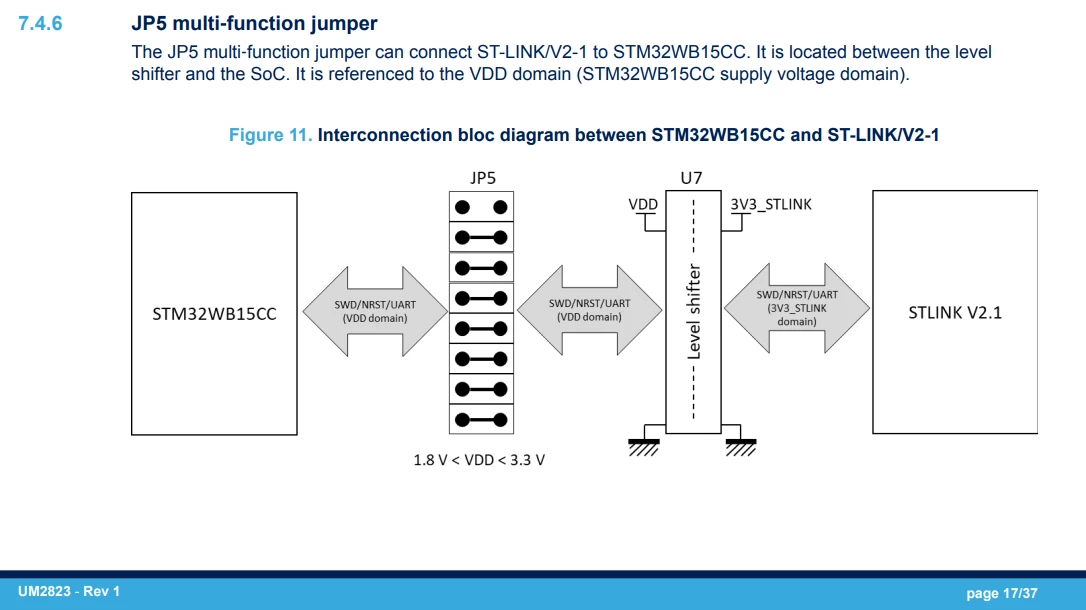

Yes.
Access via JP5:
See also Application Note AN5165, How to develop RF hardware using STM32WB microcontrollers:
https://www.st.com/resource/en/application_note/an5165-how-to-develop-rf-hardware-using-stm32wb-microcontrollers-stmicroelectronics.pdf

Feb 25, 2025 1:58 PM UTC
You mean the NUCLEO-WB55RG ?
https://www.st.com/en/evaluation-tools/nucleo-wb55rg.html
indeed:
https://www.st.com/resource/en/user_manual/um2823-stm32wb-nucleo64-board-mb1641-stmicroelectronics.pdf#page=9

Do I need the STM32F130CBT6 to control the ST-Link to program a WB55RG or is it included on the NUCLEO for ease of development?
Yes.
Access via JP5:
