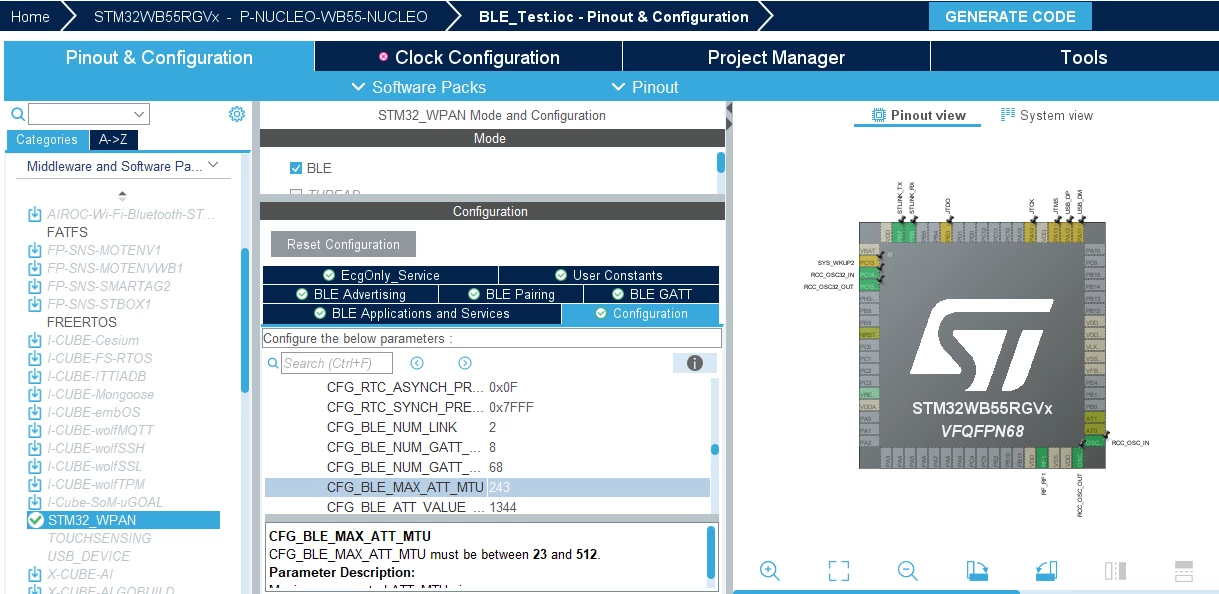

245 bytes can be sent using BLE, but 512 bytes must be extended into a single packet.
I had created a custom Nordic UART service. Ble
sending :
static tBleStatus Generic_STM_App_Update_Char_Ext(uint16_t ConnectionHandle, uint16_t ServiceHandle, uint16_t CharHandle, uint16_t CharValueLen, uint8_t *pPayload)
tBleStatus ret = BLE_STATUS_INVALID_PARAMS;
ret = aci_gatt_update_char_value_ext(ConnectionHandle,
