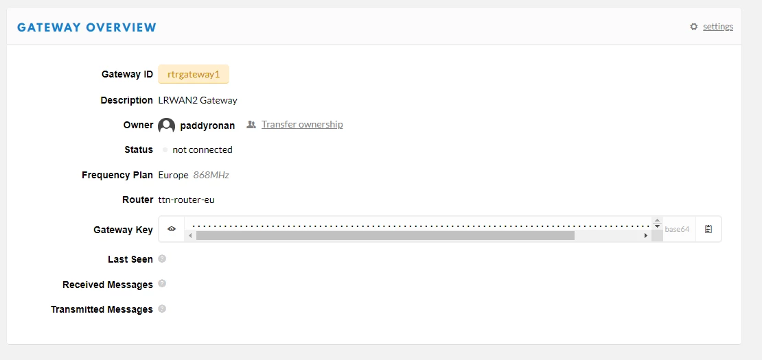

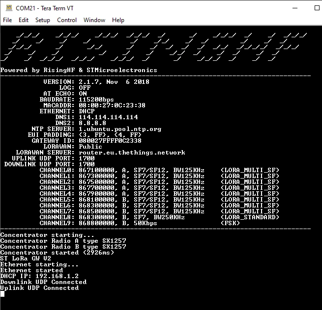

1: how do i get my gateway to be connected 2: do i need to use at commands on the I-Nucleo to communicate through it 3: how do i know if the I-Nucleo is sending it data? 4: how do i know if the gateway is receiving any data?
Hi All,
I am quite new to LoRa so if I am in the wrong forum area I do apologise. If anyone has any information based on my issues below I would appreciate a reply.
I have followed the setup guide from STMicroelectronics for the P-Nucleo-LRWAN2:
I have loaded the following bin file to the gateway: st-nucleo-lora-gw-at-fw-v2.1.7-eu868-TTN.bin
I have loaded the I-NUCLEO_LRWAN1 with the AT_Master firmware as instructed.
