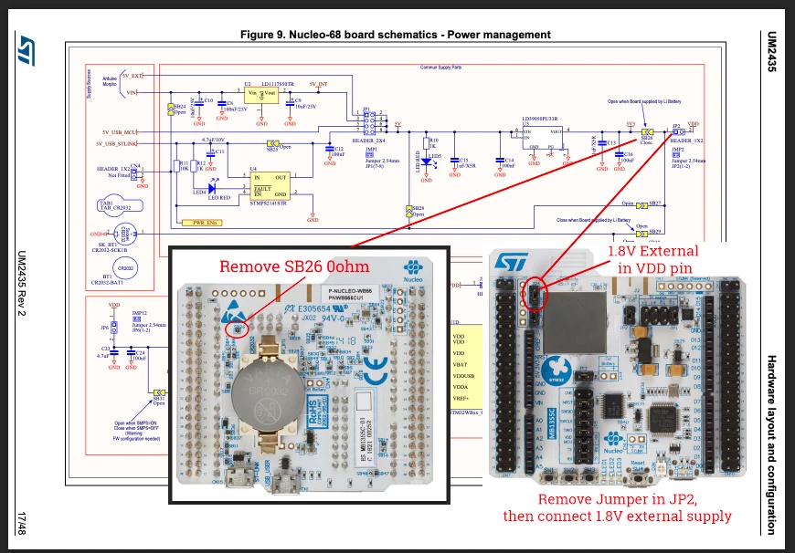

Finally, I was able to convert the board to have 1.8V in GPIOs.
The idea is based on the user manual's Power management instruction, wherein to take in external 1.8V supply and bypass the PM components related to USB voltage input.

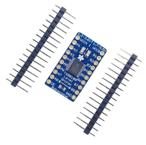

There is a 1.8V pin in the Nucleo Pack, and there is also a VDD for the STM32WB55.
Can that that 1.8V be connected to VDD (or Reference pin) so the GPIOs will be on 1.8V?
If not possible, what Level Shifter off-the-shelf board can you reco (fast shifting up to 40MHz at least).
Thanks in advance.

For the level shifter, is this viable? TXB0108?

The level shifter data sheet should list bandwidth limits. I can’t imagine it being hard to find one for 40MHz.
