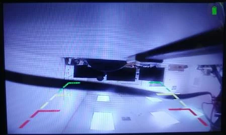

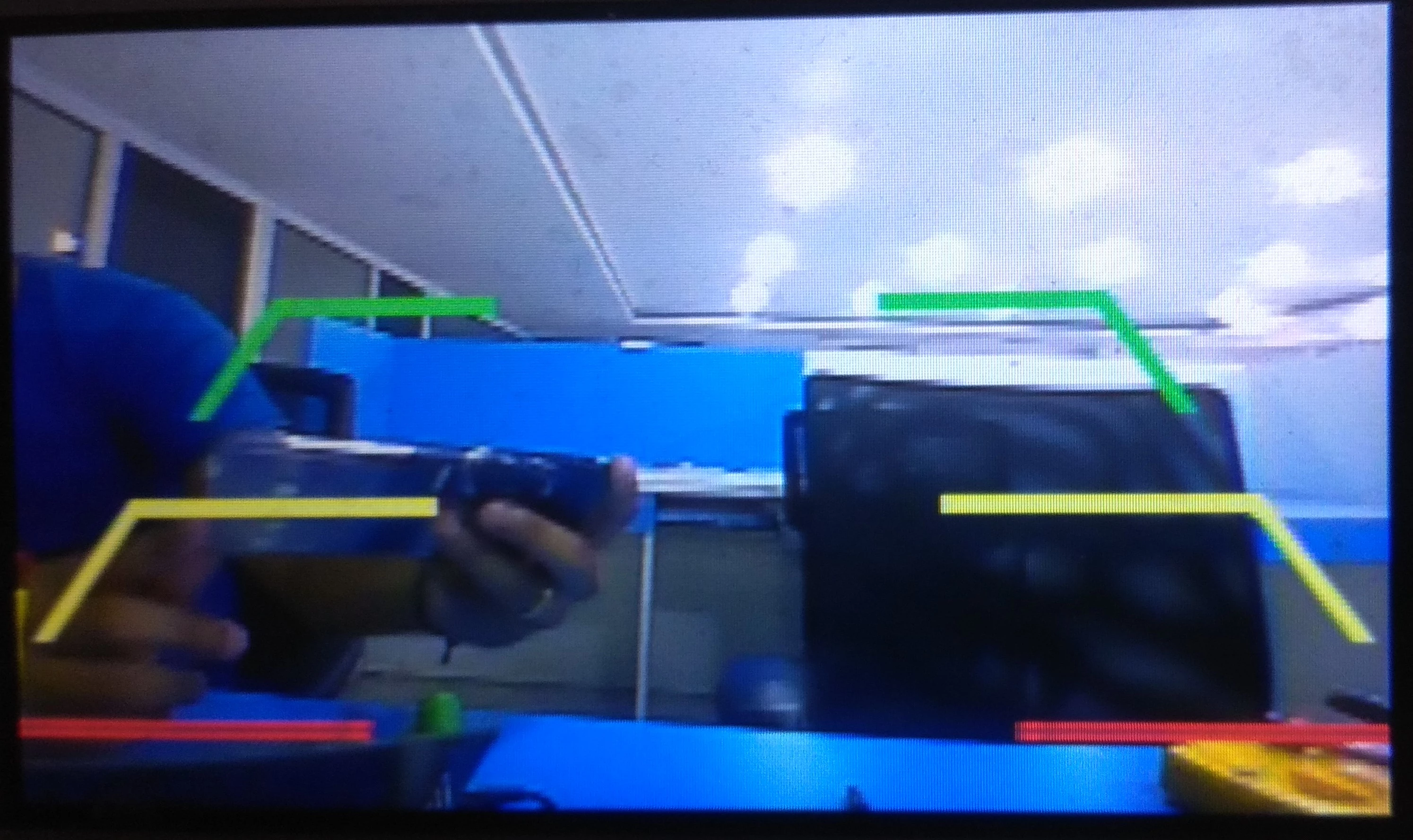

Zoom in Issue in the output video , using ADV7180 camera decoder, STM32f7 , 480*272 Display
Hello ST,
I am facing Zoom in Issue of the Video.
I am using 480*272 display.
Please help me to fix this issue. I have searched whole datasheet , but nothing found regarding the resolution.
I have adjusted the DCMI crop settings also, please point me to the solution.
I have attached the images.
fig1: Expected video resolution displayed on TV
fig2: Present output screen on the 480*272 Display which is zoomed in.
