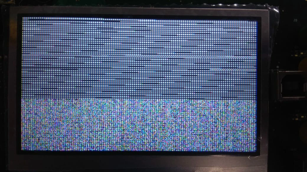

I am working on STM32F746 based custom board which is integrated with LCD and a ADV7180 video decoder IC.
I Configured the ADV7180 to run in the free run mode. Getting the Camera data using DCMI to a specified buffer.
I am trying to Convert the YCbCr 4:2:2 data to the RBG data. I am getting the Line Events. .
From the Live events I am executing the below piece of code to convert it to the RGB and then load the it to the LCD using ARGB888.
LCD_FRAME_BUFFER 0xC0000000
LCD_FRAME_BUFFER_LAYER1 0xC0130000
CAMERA_FRAME_BUFFER 0xC0260000
void LCD_LL_Test(void *pSrc, void *pDst, uint32_t lcd_offset, uint32_t cam_offset)
 uint32_t * pTempDest = (uint32_t *)(LCD_FRAME_BUFFER_LAYER1);
 uint32_t * pTempSource = (uint32_t *)(CAMERA_FRAME_BUFFER+cam_offset);
 uint32_t * pFinalDest = (uint32_t *)(LCD_FRAME_BUFFER+lcd_offset);
 uint32_t * pFinalSource = (uint32_t *)(LCD_FRAME_BUFFER_LAYER1);
 for(uint32_t i = 0; i < (480/2) ; i++ ){
 uint32_t te = *pTempSource;
 // CB Y1 CR , RESULT
 toRGB( (te>>0),(te>>8),(te>>16) ,(uint32_t *)pTempDest);
 pTempDest++;
 // CB Y2 CR , RESULT
 toRGB( (te>>0),(te>>24),(te>>16) ,(uint32_t *)pTempDest);
 pTempDest++;
 pTempSource++;
 static DMA2D_HandleTypeDef hDma2dEval;
 hDma2dEval.Init.Mode = DMA2D_M2M_PFC;
 hDma2dEval.Init.ColorMode = DMA2D_OUTPUT_ARGB8888;
 hDma2dEval.Init.OutputOffset = 0;
 hDma2dEval.LayerCfg[1].AlphaMode = DMA2D_NO_MODIF_ALPHA;
 hDma2dEval.LayerCfg[1].InputAlpha = 0xFF;
 hDma2dEval.LayerCfg[1].InputColorMode = DMA2D_RGB888;
 hDma2dEval.LayerCfg[1].InputOffset = 0;
 hDma2dEval.Instance = DMA2D;
 /* DMA2D Initialization */
 if(HAL_DMA2D_Init(&hDma2dEval) == HAL_OK)
 if(HAL_DMA2D_ConfigLayer(&hDma2dEval, 1) == HAL_OK)
 if (HAL_DMA2D_Start(&hDma2dEval, (uint32_t)pFinalSource, (uint32_t )(pFinalDest), BSP_LCD_GetXSize()*4, 1) == HAL_OK)
 /* Polling For DMA transfer */
 HAL_DMA2D_PollForTransfer(&hDma2dEval, 10);
I have initialised the LCD with LCD_FRAME_BUFFER and I am using single layer only.
I am converting the data and copying it to the LCD_FRAME_BUFFER using an intermediate LCD_FRAME_BUFFER_LAYER1 buffer.
DCMI --> CAMERA_FRAME_BUFFER --> CONVERSION --> LCD_FRAME_BUFFER_LAYER1 --> DMA -> LCD_FRAME_BUFFER
But, I am not getting the free run mode screen as BLUE Screen.
Can body point me where I am going wrong.
