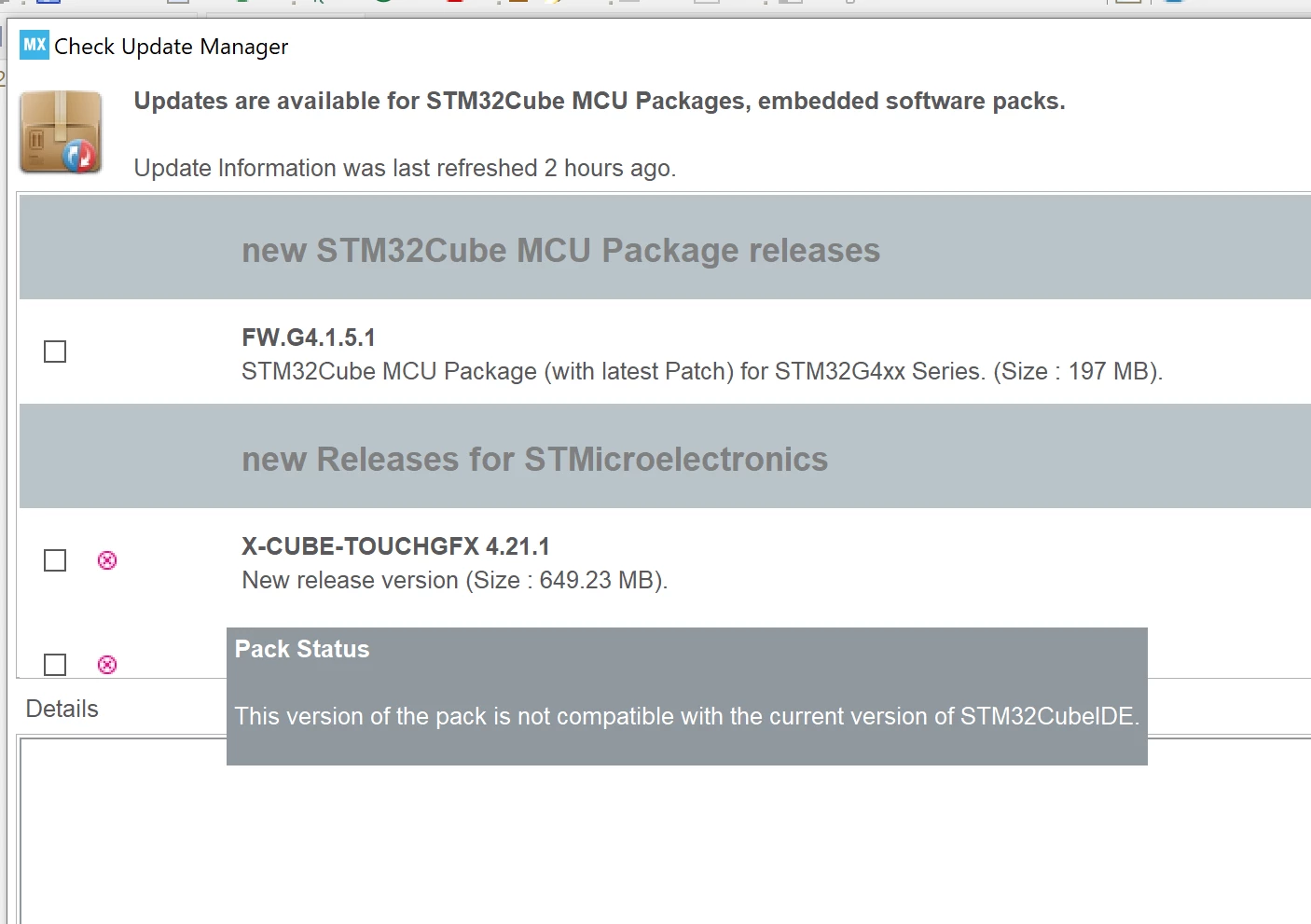

MM..1
Jan 23, 2023 1:00 PM UTC
Nice but is compatible with 1.11 IDE ? My 1.10.1 say no
Osman SOYKURT
Jan 23, 2023 2:30 PM UTC
Hello MM..1,
Can you send us a screenshot of the message you have on STM32CubeIDE please?
/Osman
MM..1
Jan 23, 2023 3:07 PM UTC
