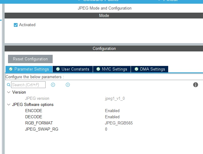

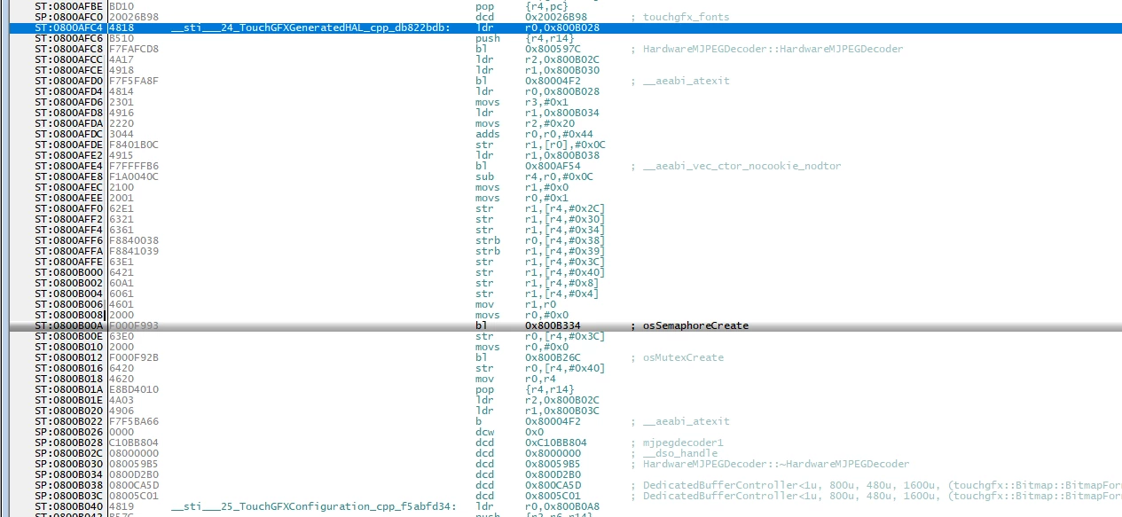

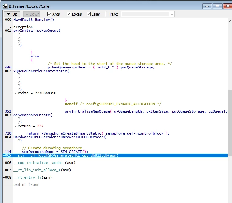

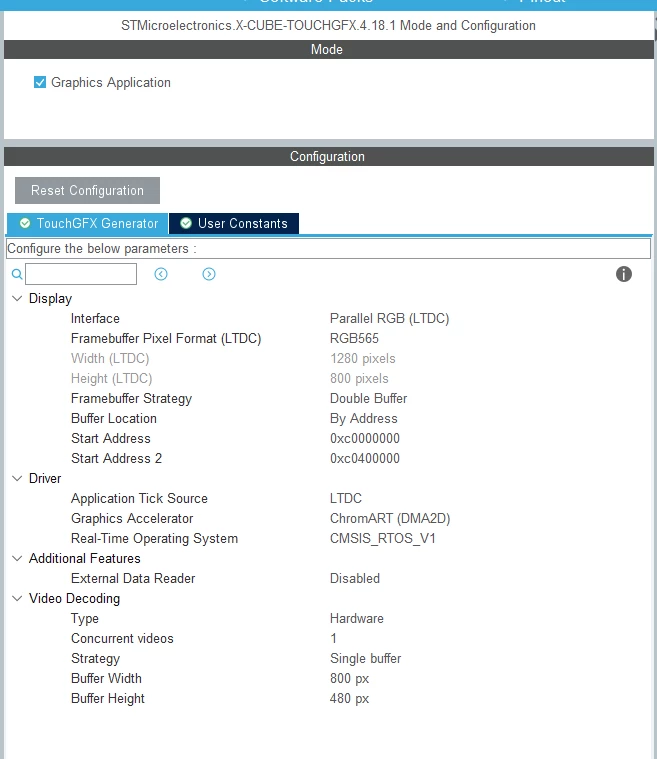

Guopeng
Mar 16, 2022 2:44 PM UTC
Solved.
When I tried this video for a STM32F767 MCU, and I enabled the hardware jpeg, and the generated code will run into hardware fault.
in __sti___24_TouchGFXGeneratedHAL_cpp_db822bdb, it will call HardwareMJPEGDecoder::HardwareMJPEGDecoder
and then call osSemaphoreCreate, but at this time, the rtos is not yet initialized, you can find my configuration in below, and let me know your comments if you have ,thanks.
