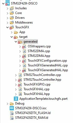

lclor
July 2, 2021
I have installed the new Touch GFX 4.17.
Created a blank project for F429_disco
Open CubeIDE, create new project from existing IOC file, but can't compile the project.
0693W00000BcdirQAB.jpgIs it the right way to do it ?
Tanks for your help.
/BR
Romain DIELEMAN
July 2, 2021
When you create a project from TouchGFX Designer with the TouchGFX Board Setup (new name for Application Template) for the STM32F429 disco board and generate code from TouchGFX Designer, a fully configured STM32CubeIDE project will be generated for you. To open it you just have to double click on the .cproject or .project under the <project name>/STM32CubeIDE folder (no need to use the "create new project from existing IOC file" option).
/Romain

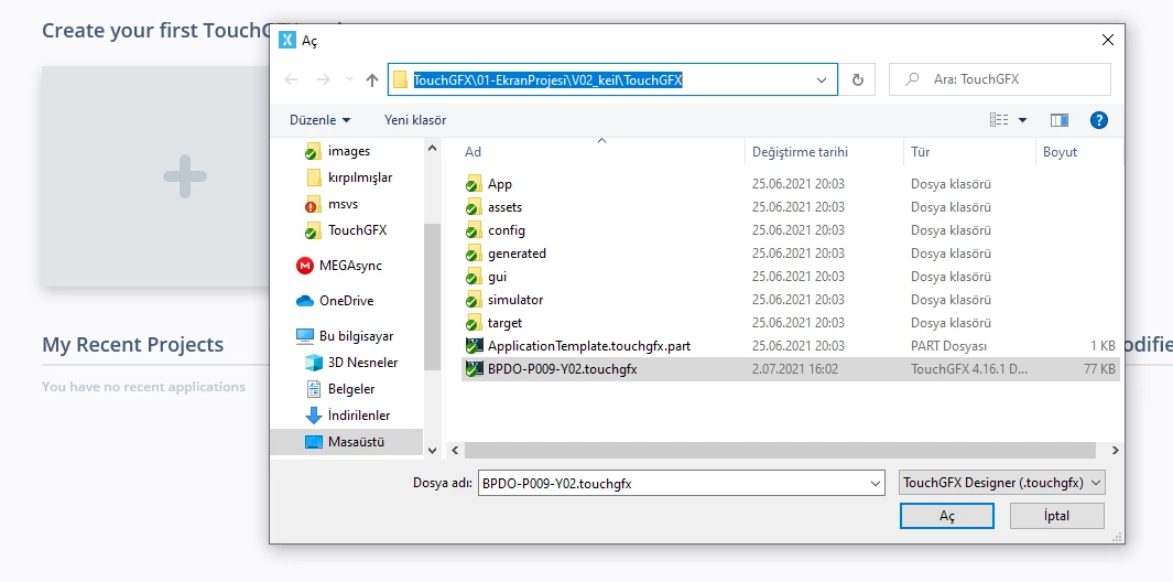

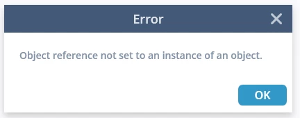

Ezgi
July 2, 2021
I have a project with 4.16.1 version and I want to update it to 4.17. However, when I open the project in the TGFX Designer ,I get "Object reference not set to an instance of an object." error. What should I do?
Romain DIELEMAN
July 2, 2021
Could you share your project ? Or a screenshot of your folder + path, and of the error message ?
/Romain
Ezgi
July 5, 2021
0693W00000BcnGSQAZ.png0693W00000BcnGhQAJ.pngIn addition, I can't create a new project and got this error

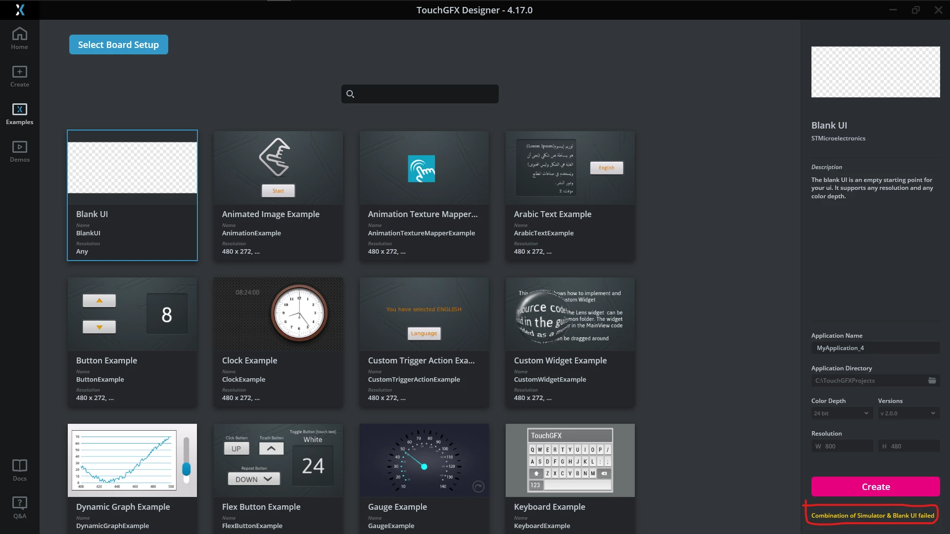

Hi, I installed TouchGFXDesigner 4.17.0 and when I try to create a new project I always got error. I want to try cacheable container feature which mentioned at this link: https://support.touchgfx.com/docs/development/ui-development/scenarios/achieving-better-performance-with-cacheable-container .
I have another problem about D-cache. If I have disabled D-cache, the informations on the TFT screen which I have created via TouchGFX Designer 4.16.1 are always true but sometimes software goes hard fault. If I have enabled D-cache software running is good but this time screens getting stuck.
Romain DIELEMAN
July 5, 2021
What error do you face when you try to create a project ? Could you share a screenshot ?
The D-cache is a known issue but should have been fixed with TouchGFX 4.17 I believe. What mcu are you working with ? Did you use a TouchGFX Board setup (new name for Application Template) or a custom project ? Have you tried debugging to see where the screen gets stuck ?

Özkan
Visitor II
July 5, 2021
I tried to go with Blank UI and got this error. I have also tried Board setup and etc. Nothing changed.0693W00000BcpMDQAZ.pngI am working with STM32H743VGT6. If D-cache is enabled software can't run correctly. For example, I programmed a button to change screen but when I press the button doesn't work. If D-cache is disabled everything is working as it should be except sometimes getting hardfault.

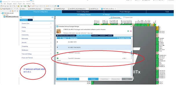

Mkuma.5
July 12, 2021
i installed  X-CUBE-TOUCHGFX 4.17.0 from stm32cube->software packages. But its(generator) not appearing on my stm32CubeIDE 1.6.1 category menu to configure the generator. Please advise.
Romain DIELEMAN
July 12, 2021
You need to enable "TouchGFX Generator" for your project by clicking on the "Software packs" button, then "Select Software", and enable TouchGFX 4.17. Follow this article in the documentation.
