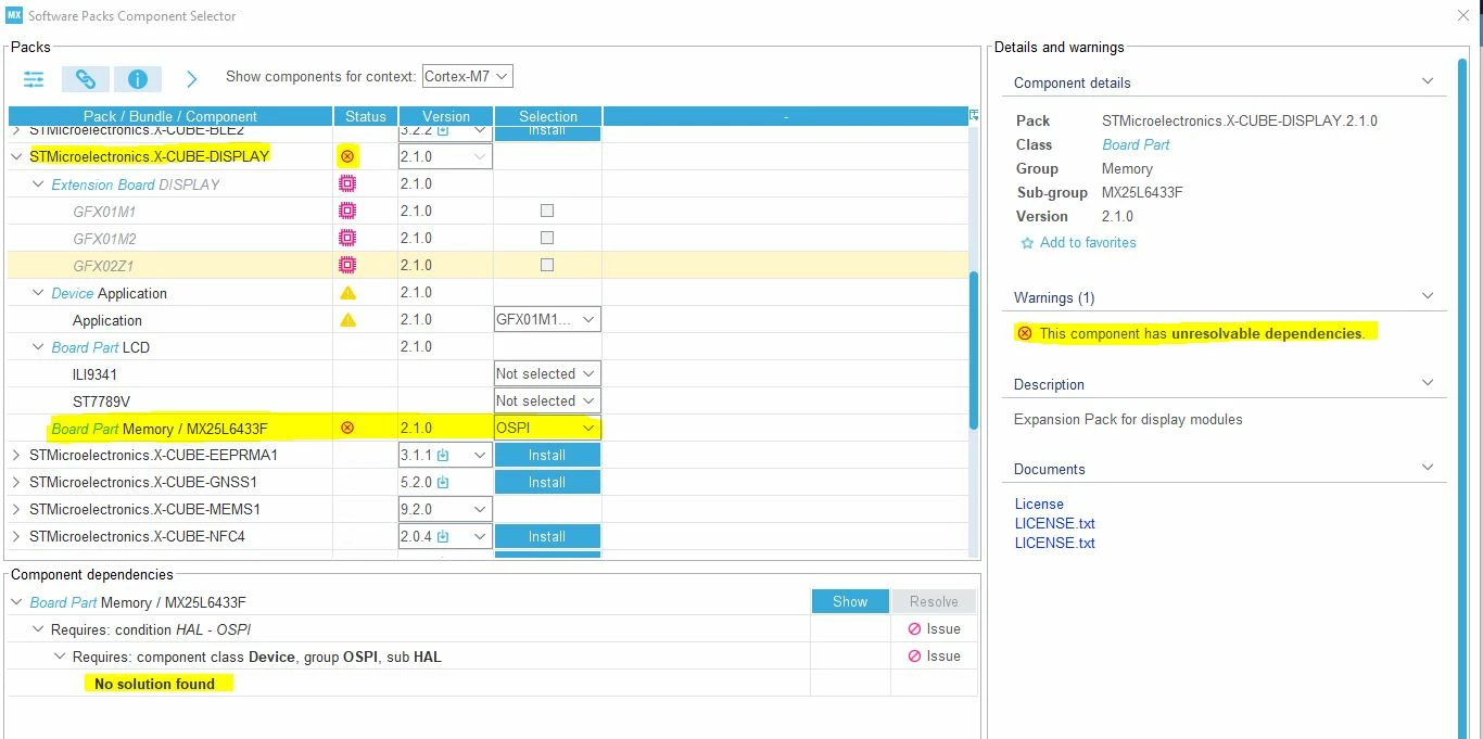

X-CUBE-DISPLAY 2.0.1 Not Support the QSPI Mode Configuration
It looks like the X-CUBEDISPLAY 2.0.1 software package is not supported the QSPI mode configured, it is only supported the SPI or the OSPI mode . The NUCLEO-H755ZI-Q is supported the SPI or QSPI mode only. Anyone know how to configure the X-CUBE-DISPLAY 2.0.1 with the QSPI mode ? Please Help , thanks.

Now for the NUCLEO-H755ZI-Q, it seems that there are some compatibility issues with the X-Cube-Display and the OCTOSPI component has unresolvable dependencies. I have attached a screenshot.
0693W00000NrSI6QAN.jpgI recommend you trying another MCU or board that suits your application.

Pretty sure the H755 doesn't have OCTOSPI, and the Macronix "L" part is QUAD, so I can see that being an unbridgeable dependency, and perhaps something the tool should be wise too, and offer/show things that are workable.
I've definitely had the MX25L64 on the GFX02Z1 working in QUADSPI on a NUCLEO-H743ZI
On MB1363 (H7A3,H755) SB88 needs to be removed to de-conflict PE2, SB87 stays on, it's the side connecting to QSPI D2
CLK PB2:AF9 SB51
NCS PG6:AF10
D0 PD11:AF9
D1 PD12:AF9
D2 PE2:AF9 SB88:OFF,SB87:ON
D3 PD13:AF9
