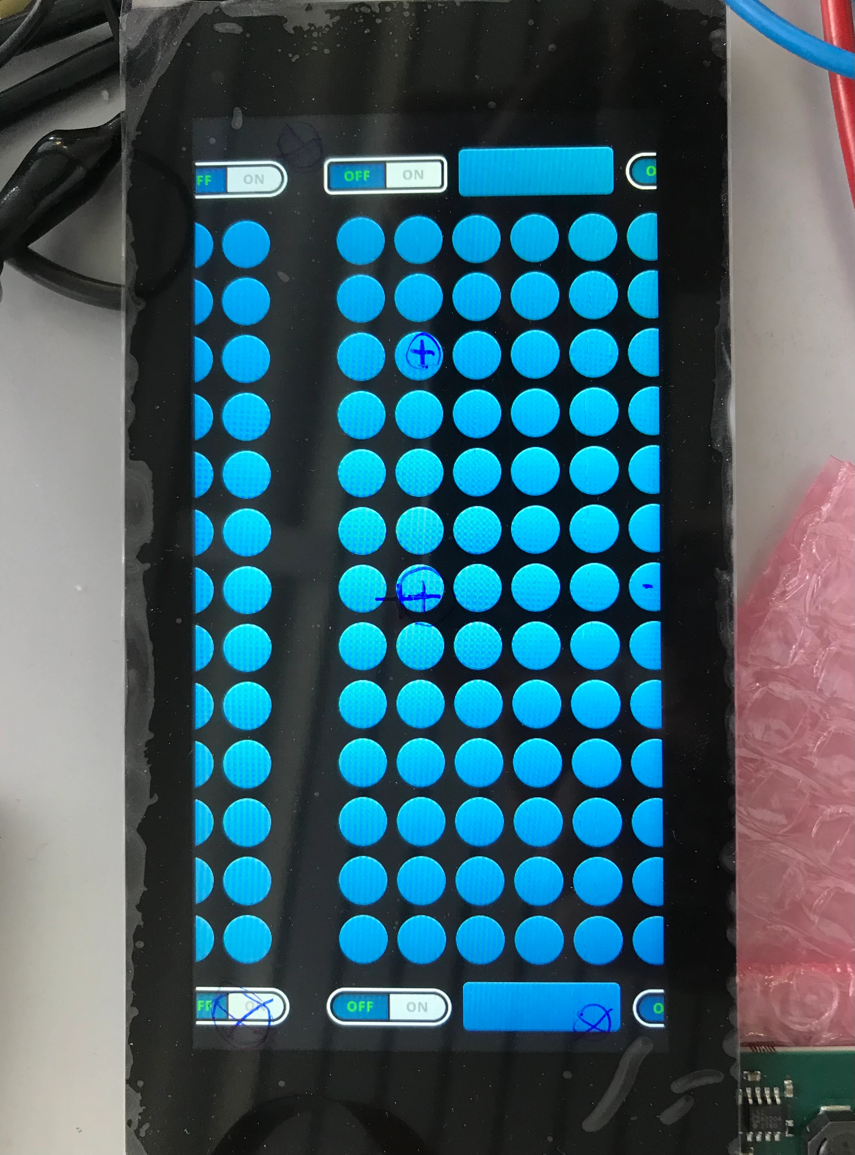

Wrong representation of screen. (Shifted image)
Sometimes an image tells more than a thousand words:
0693W00000LywVLQAZ.jpgAs you can imagine, the dots shouldn't be shifted to the right as on my display (there is an offset on the x-axis)
This is my very example template (lots of buttons to test my touch).
I use the STM32F469 controller and my display is a ILI9881.
When I use the same display with the STM32 Disco Techstar Board everything works fine.
I have no reference where to look for my misrepresentation.
I appreciate your help
Cheers Jimmy

Luckily, I was able to figure out what the problem was:
In CUBEMX at Multimedia/DSIHOST I use the "Adapted Command Mode with TE Pin".
As external clock, I used a 16MHz quartz instead of the 8MHz quartz at the STM32 Disco Board.
Therefore, the PLL was set too high for the DSIHOST which caused the explained misrepresentation.
For completeness stake:
I use Touch GFX version 4.19.1
I have an external RAM
As frame buffer strategy I use single buffer.

Hello Jiimmy,
Can you give more information about your configuration please ?
  • Which version of TouchGFX Designer do you use ?
  • Do you have internal/ external ram ?
  • Which framebuffer strategy do you use ?
/Osman
