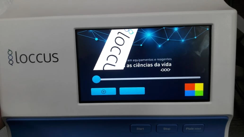

This is how the colors are displayed on the physical display:
Notice how the gradients effects are displayed on the display.

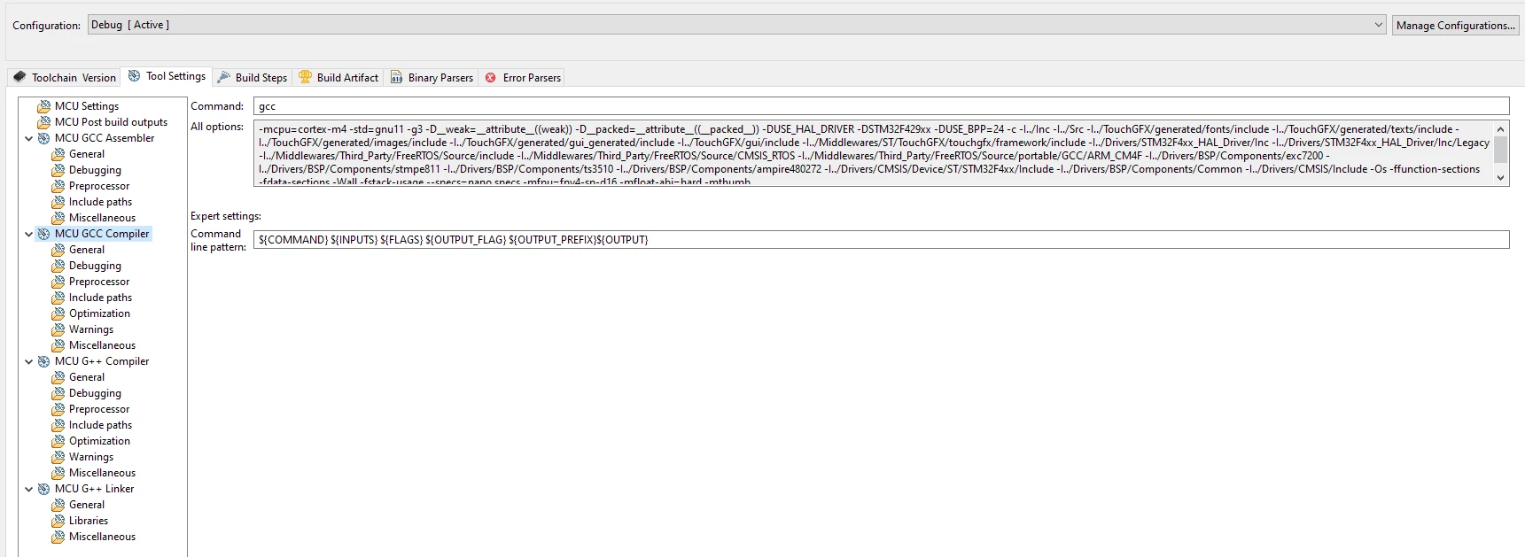

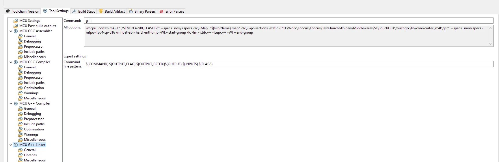

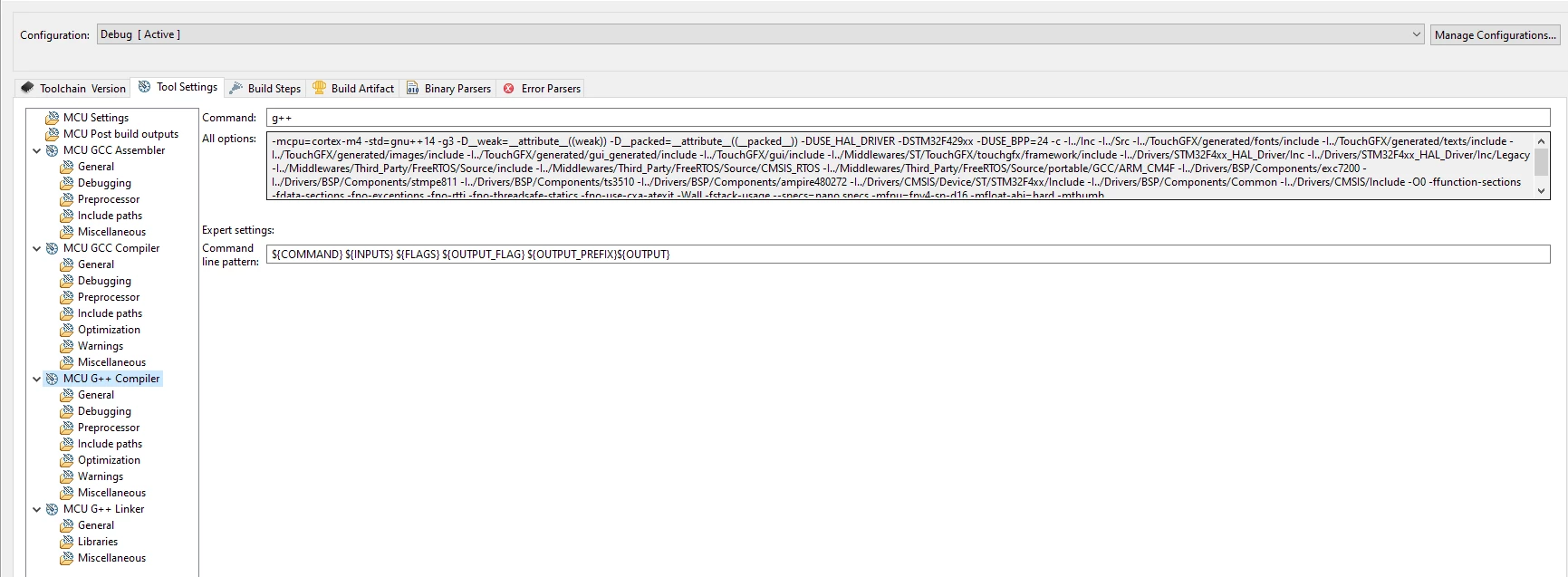

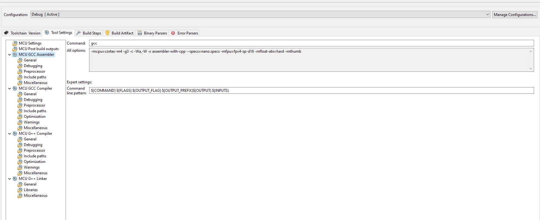

I'm not sure if I'm using the right configurations for my application. I'm using STM32Cube IDE.

Fernando Cola
Sep 6, 2019 1:13 PM UTC
Hi Martin, you nailed it. Yesterday I revised the LCD GPIO configurations and turns out some pins were wrongly assigned. I fixed and the display is working properly with the gradients now. This was very tricky because since solid RGB colors were fine and we got confused thinking that the display didn't support RGB888 colors.
