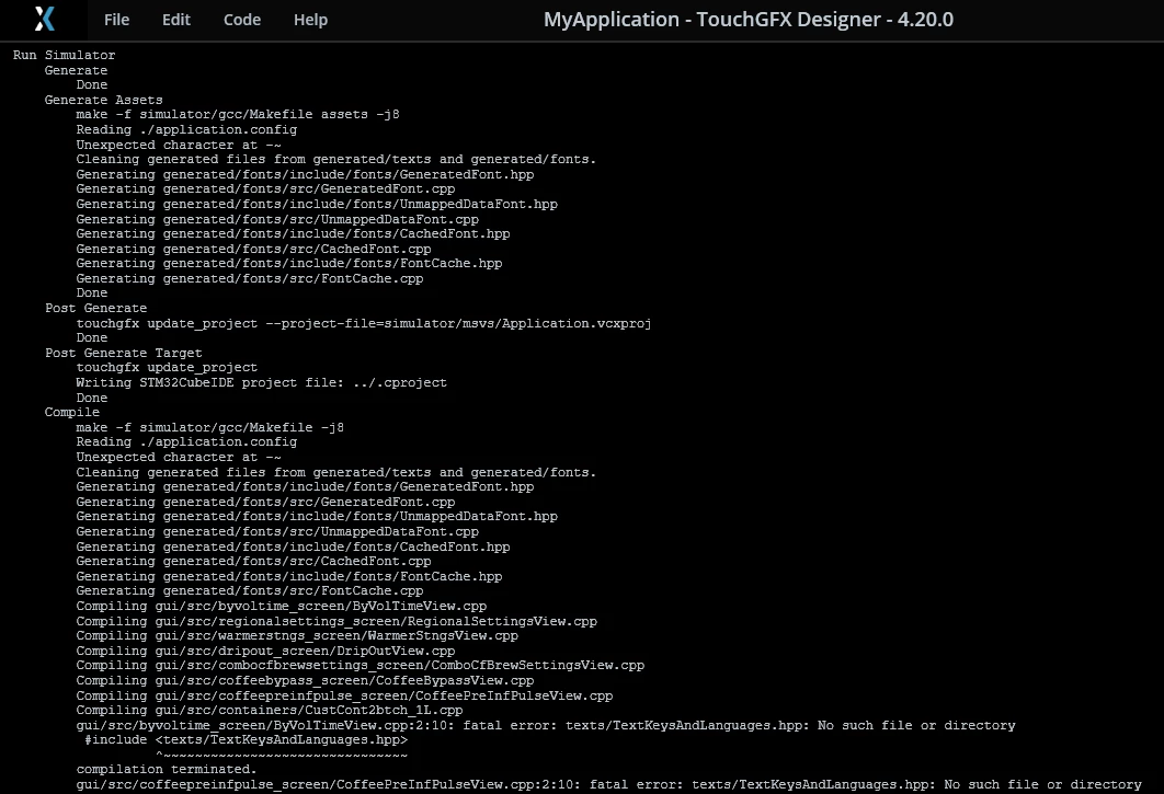

I have been working on a project for many months now with TouchGFX v4.20.  I was modifying some of the text strings I had defined in TouchGFX Designer and now the texts/TextKeysAndLanguages.hpp is no longer being generated.
When trying to start the simulator I see that it says something about an unexpected character (see below output).  This is halting any work I can do with TouchGFX anybody ever experience this??
Run Simulator
Generate
Done
Generate Assets
make -f simulator/gcc/Makefile assets -j8
Reading ./application.config
Unexpected character at -~
Cleaning generated files from generated/texts and generated/fonts.

    I guess something got corrupted somehow, I was able to go back to work I saved 3 days ago and start there.  Everything builds fine again.  Was able to incorporate everything I had done over the past 3 days and still works fine so I guess all is well.  Not sure how the TouchGFX project got corrupted but it did.
