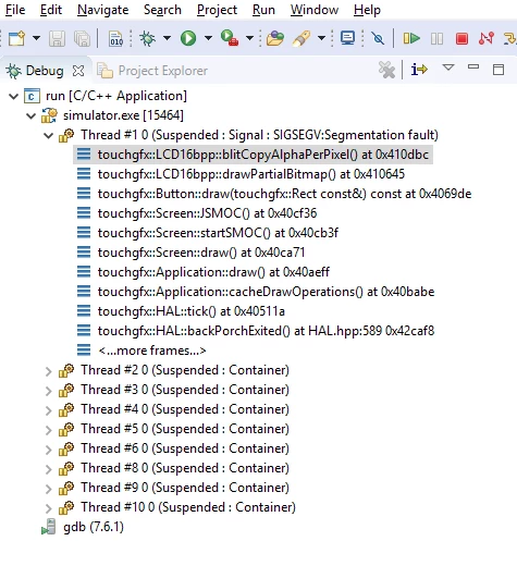

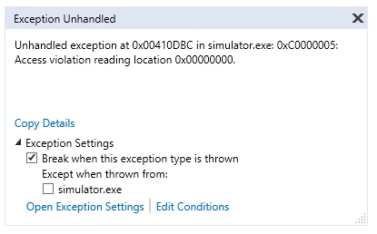

Everything works fine when using TouchGFX Designer to run a simulation on a Windows PC. But we are trying to build everything with CMake in Eclipse. And when using a single button we get the following stack trace (see attachment). It seems that it is a nullptr that is the problem. We do not have the sources for this to further debug (no thanks ASM).
When using only hardcoded text, Eclipse/CMake works exactly as TouchGFX Designer Windows simulation. ✔�?
When using a toggle button, the simulation does not crash (as it does when using a Button), but the toggle button is NOT drawn. However the hard-coded text is drawn fine.

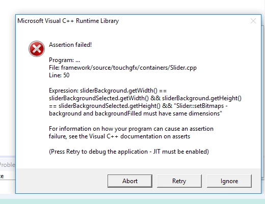

When using a Slider, we get an assertion statement (see attachment). When continuing, the source pointer is 0x3, i.e. in restricted memory.

This assert tells us that your assets for the slider do not align properly. Did you verify what is claimed?

We just put a new slider into our TouchGFX. We are using the example getting started project and we are doing absolutely nothing special. Out-of-the-box, we cannot get this to work as a Windows Simulation.
However we have had success making this work on the target.
Do you think maybe some compiler flags, linker flags or Compiler Versions could be the cause of this?
Regarding the slider assertion again, if I continue in the code, a memcpy is performed by the library. It is trying to access invalid memory by trying to copy some 700 bytes from location 0x3. So there must be something we have not figured out in the settings to reproduce this in our build.

I highly doubt it's anything to do with compiler flags. assert() could do nothing in your target compiler making it run fine ( but might look wrong ). The code for Slider.cpp tells us:
assert(sliderBackground.getWidth() == sliderBackgroundSelected.getWidth() &&
 sliderBackground.getHeight() == sliderBackgroundSelected.getHeight() &&
 "Slider::setBitmaps - background and backgroundFilled must have same dimensions");
Can i see your project?
