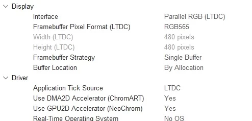

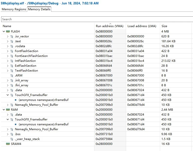

I made a touchgfx project by CubeIDE,when I choose touchgfx framebuffer by allocation,after build ,the framebuffer is placed into flash,then ram.I wonder why.

Hi @amb ,
It seems to be located at RAM 0x2001b0 right ? I guess the issue is that it is initialized by C++ RTE. The frame buffers needs to be marked by some gcc speciofic __attribute__, hm is it 'noinit' ?
[Edit]
https://www.nongnu.org/avr-libc/user-manual/mem_sections.html
The .noinit Section
This sections is a part of the .bss section. What makes the .noinit section special is that variables which are defined as such:
int foo __attribute__ ((section (".noinit")));
will not be initialized to zero during startup as would normal .bss data.

I see file
\ST\touchgfx\framework\include\touchgfx\hal\Config.hpp
has many defines dealing with that sort of problems. It is a jungle and I run simulation so cant check with embedded toolchain.

The framebuffer needs to be in the RAM (either internal or external). But how you did conclude that the frame buffer is located in the Flash? Which board are you using? ST or custom board? which MCU?
Need to provide more details, so TouchGFX expert(s) could help you.

this is the memory details form CubeIDE.

this is touchgfx settings
