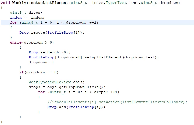

Why simulator crashes when I call function in another class?
I've created a list and need to get value from model.hpp and using
WeeklyScheduleView objs;
drops = objs.getDropDownClicks();
to get value. But when it calls it crashes.

Check if presenter is a valid pointer, maybe it is uninitialized.

Do you mean about this?
Senior II
Apr 17, 2023 11:18 AM UTC
Set a breakpoint to the line return presenter->getScheduleDropDown() and see if presenter has a valid address or check at runtime with if (presenter != nullptr) { the line before

Hello heyo,
It crashes at Drop.remove(ProfileDrop[i]) or drops = objs.getDropDownClicks() ?
Also, what is your Drop object?

At drops = objs.getDropDownClicks(). It always crashes when I try to call function in other class.
Do you mean Drop? Drop is a list. The only way calls other function in other class works when container is included in view window

Did you resolve your issue? If not, can you share your project?
