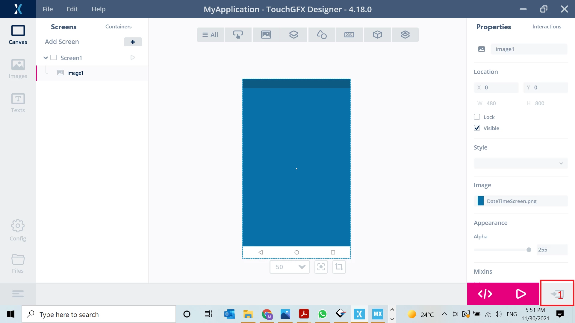

i am using touchGFX designer V4.18.0. In software run target option is disabled.
how can i recover that so please tell me the process to get run target option.
10 replies
mchin.1
mchin.1Author
November 30, 2021
0693W00000GZW8aQAH.pngPlease check in picture.

mchin.1
mchin.1Author
November 30, 2021
what ? that is not a cause..
If i opened directly from touchGFX designer that run target option came in active.
I did the below process.
took a stmcubemx .ioc file from my old project because of some usb related errors in touchGFX.
Copy that file in to a new floder
Opened & Generate code again.
Got TouchGFX .part file & stmcubeide folders.
Opened .part file & browse my old touchGFX file
So at that time only I lost run target option in my touchGFX designer.
Something is happened . So please tell me Experts this issue need to be cleared for me

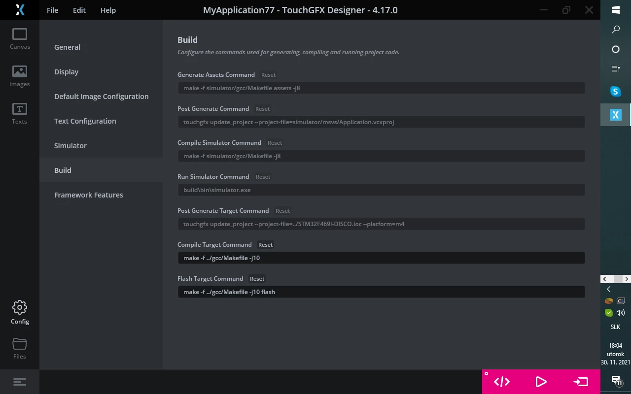

MM..1
November 30, 2021
Target enabling is based on enter comands in config build
0693W00000GZXM5QAP.pngin normal project generated from .part file have this empty
