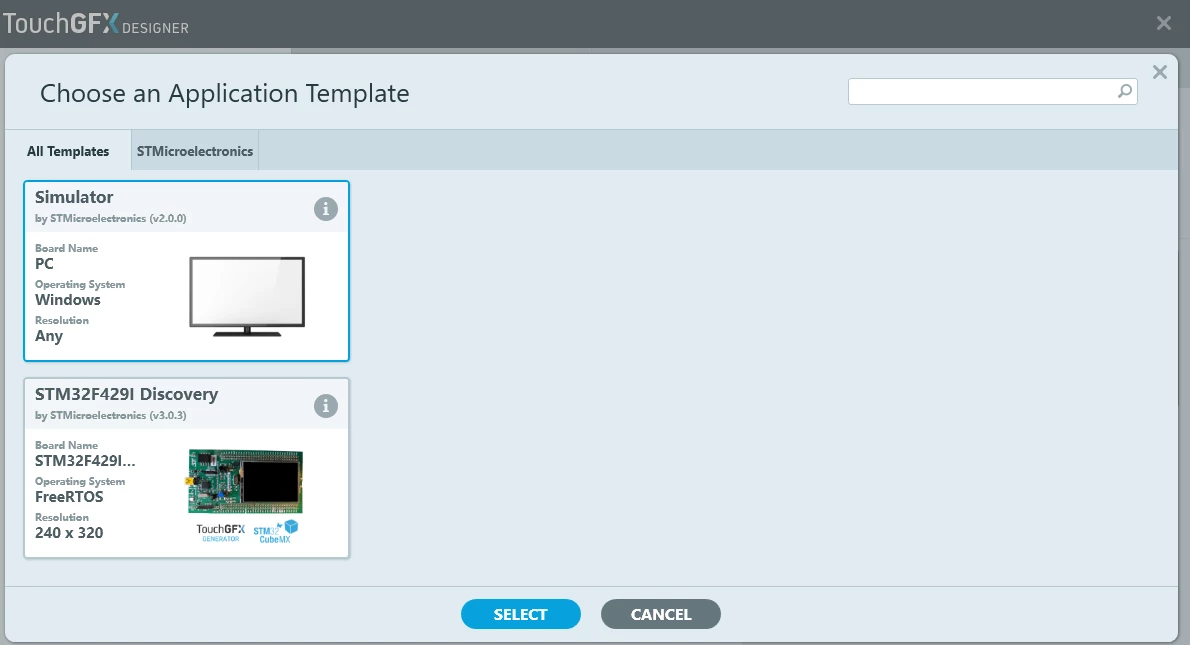

Why my touchGFX Designer 's application templates only has PC and STM32F429 Discovery board template.
  • January 28, 2021
  • 6 replies
  • 2802 views
0693W000007D6BnQAK.pngI install touchGFX Designer 's 4.16.0. The application templates only has PC and STM32F429 Discovery board template. Even when I connect the network, but the lab of the online application is still disabled, so I can not enter this menu.
If there some configuration or packages I missed. I remembered that before now, I can create application templates based on some other discovery boards.
So how I can I see other templates. Because I want to use STM32F746 discovery board to do some evaluation.

I too have the same issue right now. I think the problem is due the template package site being down at the moment. I could be wrong.

Yes. Someone has meet this problem at 2019. See the link. https://community.st.com/s/profile/0050X000009xxkXQAQ.
The response from ST engineer is that --This could be a proxy thing.
The missing templates indeed are caused by network restrictions. On a PC with full internet access we can see a number of application templates. So next we will try to generate a F429 project and adapt to our F103.
I'm not very clearly about "full internet access", because my laptop is company's.
