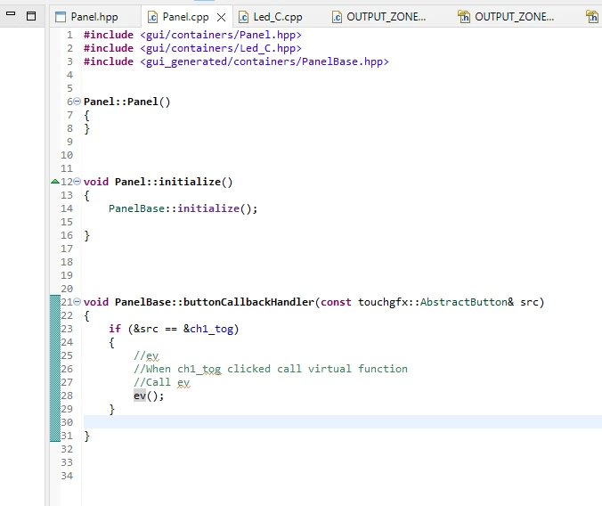

this is the generated code
when i try to add this to add this to panel.cpp     (the custom container, just compiler errors ???
void PanelBase::buttonCallbackHandler(const touchgfx::AbstractButton& src)
if (&src== &ch1_tog)
//ev
//When ch1_tog clicked call virtual function
//Call ev
ev();
if (&src== &ch8_tog)
//JIMJIM
//When ch8_tog clicked call virtual function
//Call JIMJIM
JIMJIM();

if I only try one event like below....
//ev
//Call ev
ev();
i still get errors ???
15:03:55 **** Incremental Build of configuration Debug for project Riverdi_70STM32H7_CM7 ****
make -j8 all
arm-none-eabi-g++ "C:/TouchGFXProjects/Train/CM7/TouchGFX/gui/src/containers/Panel.cpp" -mcpu=cortex-m7 -std=gnu++14 -g3 -DDEBUG -DCORE_CM7 -DUSE_HAL_DRIVER -DSTM32H747xx -c -I../../../CM7/Core/Inc -I../../../CM7/FATFS/Target -I../../../CM7/FATFS/App -I../../../CM7/TouchGFX/App -I../../../CM7/TouchGFX/target/generated -I../../../CM7/TouchGFX/target -I../../../Drivers/STM32H7xx_HAL_Driver/Inc -I../../../Drivers/STM32H7xx_HAL_Driver/Inc/Legacy -I../../../Utilities/JPEG -I../../../Middlewares/Third_Party/FatFs/src -I../../../Middlewares/Third_Party/FreeRTOS/Source/include -I../../../Middlewares/Third_Party/FreeRTOS/Source/CMSIS_RTOS_V2 -I../../../Middlewares/Third_Party/FreeRTOS/Source/portable/GCC/ARM_CM4F -I../../../Drivers/CMSIS/Device/ST/STM32H7xx/Include -I../../../Drivers/CMSIS/Include -I../../CM7/../../CM7/Middlewares/ST/touchgfx/framework/include -I../../CM7/../../CM7/TouchGFX/generated/fonts/include -I../../CM7/../../CM7/TouchGFX/generated/gui_generated/include -I../../CM7/../../CM7/TouchGFX/generated/images/include -I../../CM7/../../CM7/TouchGFX/generated/texts/include -I../../CM7/../../CM7/TouchGFX/generated/videos/include -I../../CM7/../../CM7/TouchGFX/gui/include -I../../../CM7/USB_HOST/App -I../../../CM7/USB_HOST/Target -I../../../Middlewares/ST/STM32_USB_Host_Library/Core/Inc -I../../../Middlewares/ST/STM32_USB_Host_Library/Class/MSC/Inc -O0 -ffunction-sections -fdata-sections -fno-exceptions -fno-rtti -fno-use-cxa-atexit -Wall -femit-class-debug-always -fstack-usage -fcyclomatic-complexity -MMD -MP -MF"Application/User/gui/Panel.d" -MT"Application/User/gui/Panel.o" --specs=nano.specs -mfpu=fpv5-d16 -mfloat-abi=hard -mthumb -o "Application/User/gui/Panel.o"
arm-none-eabi-g++ -o "Riverdi_70STM32H7_CM7.elf" @"objects.list" -l:libtouchgfx-float-abi-hard.a -mcpu=cortex-m7 -T"C:\TouchGFXProjects\Train\STM32CubeIDE\CM7\STM32H747XIHX_FLASH.ld" --specs=nosys.specs -Wl,-Map="Riverdi_70STM32H7_CM7.map" -Wl,--gc-sections -static -L../../CM7/../../CM7/Middlewares/ST/touchgfx/lib/core/cortex_m7/gcc -LC:/TouchGFXProjects/70STM32H7_v4_Copy/CM7/Middlewares/ST/touchgfx/lib/core/cortex_m7/gcc -LE:/TouchGFX/4.22.0/designer/Riverdi_70STM32H7/CM7/Middlewares/ST/touchgfx/lib/core/cortex_m7/gcc -LC:/TouchGFXProjects/MyApplication_56/CM7/Middlewares/ST/touchgfx/lib/core/cortex_m7/gcc -LC:/TouchGFXProjects/Train/CM7/Middlewares/ST/touchgfx/lib/core/cortex_m7/gcc --specs=nano.specs -mfpu=fpv5-d16 -mfloat-abi=hard -mthumb -Wl,--start-group -lc -lm -lstdc++ -lsupc++ -Wl,--end-group
C:/ST/STM32CubeIDE_1.13.0/STM32CubeIDE/plugins/com.st.stm32cube.ide.mcu.externaltools.gnu-tools-for-stm32.11.3.rel1.win32_1.1.0.202305231506/tools/bin/../lib/gcc/arm-none-eabi/11.3.1/../../../../arm-none-eabi/bin/ld.exe: ./Application/User/gui/Panel.o: in function `PanelBase::buttonCallbackHandler(touchgfx::AbstractButton const&)':
C:/TouchGFXProjects/Train/CM7/TouchGFX/gui/src/containers/Panel.cpp:22: multiple definition of `PanelBase::buttonCallbackHandler(touchgfx::AbstractButton const&)'; ./Application/User/generated/PanelBase.o:C:/TouchGFXProjects/Train/CM7/TouchGFX/generated/gui_generated/src/containers/PanelBase.cpp:296: first defined here
collect2.exe: error: ld returned 1 exit status
make[1]: *** [makefile:100: Riverdi_70STM32H7_CM7.elf] Error 1
make: *** [makefile:93: all] Error 2
"make -j8 all" terminated with exit code 2. Build might be incomplete.
15:04:00 Build Failed. 4 errors, 0 warnings. (took 5s.186ms)

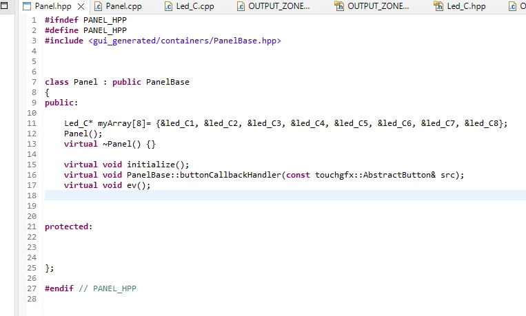

Sep 18, 2023 2:57 PM UTC
from ../../CM7/../../CM7/TouchGFX/gui/include/gui/output_zone1_screen/OUTPUT_ZONE1View.hpp:4,
from C:/TouchGFXProjects/Train/CM7/TouchGFX/gui/src/output_zone1_screen/OUTPUT_ZONE1View.cpp:1:
../../CM7/../../CM7/TouchGFX/gui/include/gui/containers/Panel.hpp:16:18: error: cannot declare member function 'PanelBase::buttonCallbackHandler' within 'Panel'
16 | virtual void PanelBase::buttonCallbackHandler(const touchgfx::AbstractButton& src);

MM..1
Sep 18, 2023 2:59 PM UTC
You know what is C++ ?

MM..1
Sep 18, 2023 3:20 PM UTC
Then why you place PanelBase into other class and ask why compiler say error.?
I agree learn TGFX is not easy. My tip is half year.
I disagree, examples is in designer , but in new version is more complicated to open.

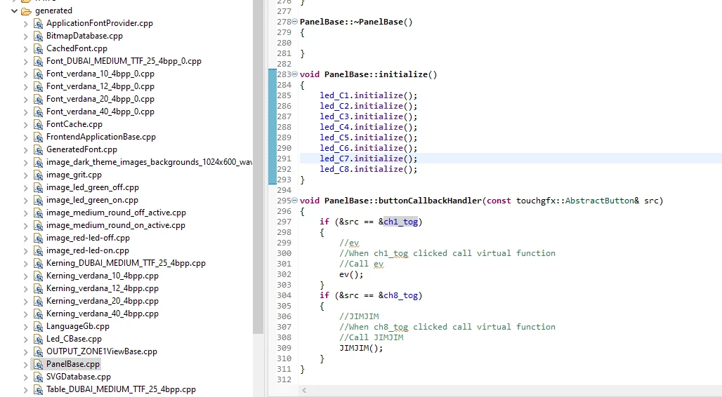

Sep 18, 2023 3:31 PM UTC
this is the code touchGfx generated ???
Graduate II
Sep 19, 2023 9:39 AM UTC
Hello.
You dont need to make buttonCallbackHandler by yourself to panel-class. Just add ev and JIMJIM- functions to panel class. Tgfx generates calls to those automatically to the panelbase- class. You found empty declations in panelbase.hpp file for those functions, just copy/modify those to the panel.hpp/.cpp
There is also example about simple button operation. Open tgfx designer and select examples on the left menu. I guess these examples are good way to learn how to use different widgets. You can select simulator as  target board if you just want to test different examples.
Hope you get forward, and ask more if needed.
Br J.T

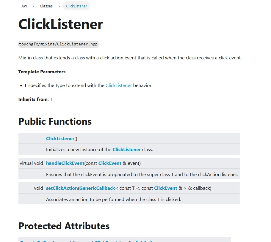

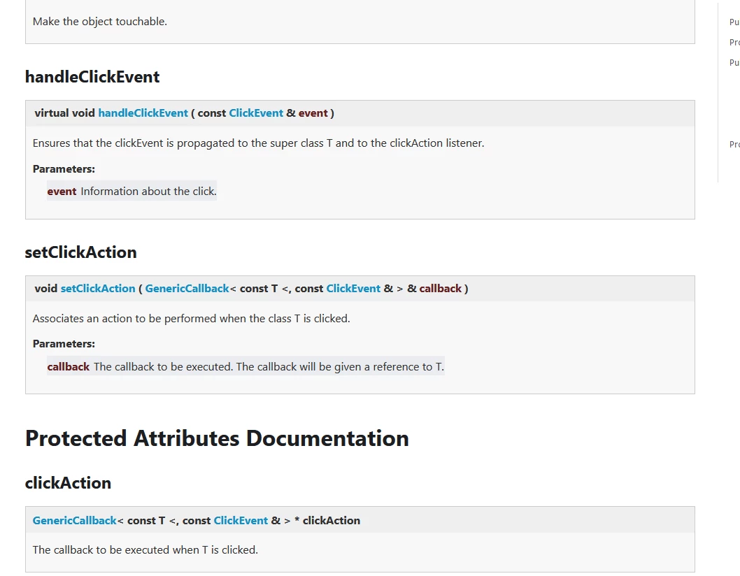

Sep 19, 2023 8:12 AM UTC
this type of page is so unhelpful ???
There should be 5 or 6 examples at the bottom showing how the click listner works ????/
the pages really mean nothing to me, very dificult to understand and no help at all >???
