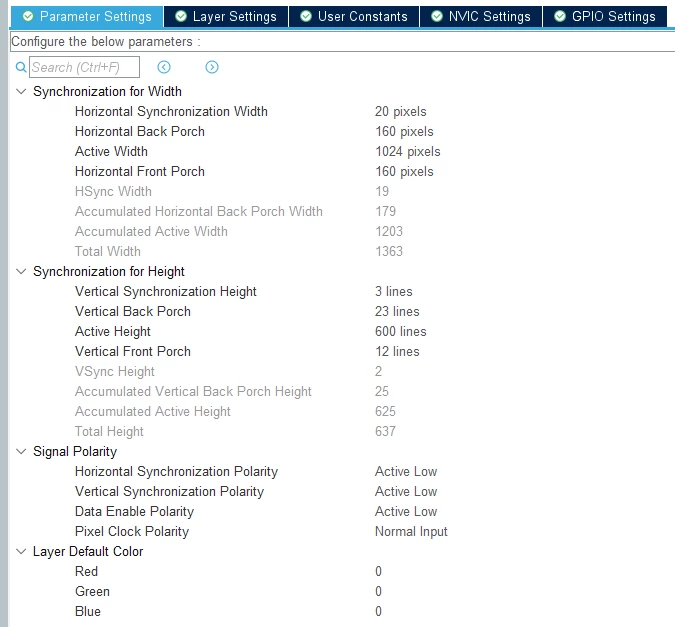

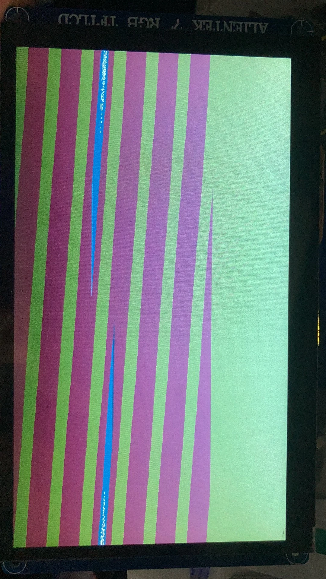

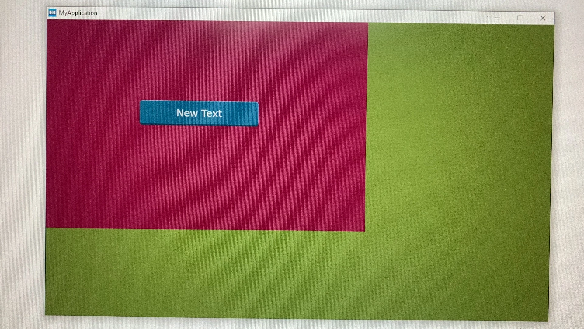

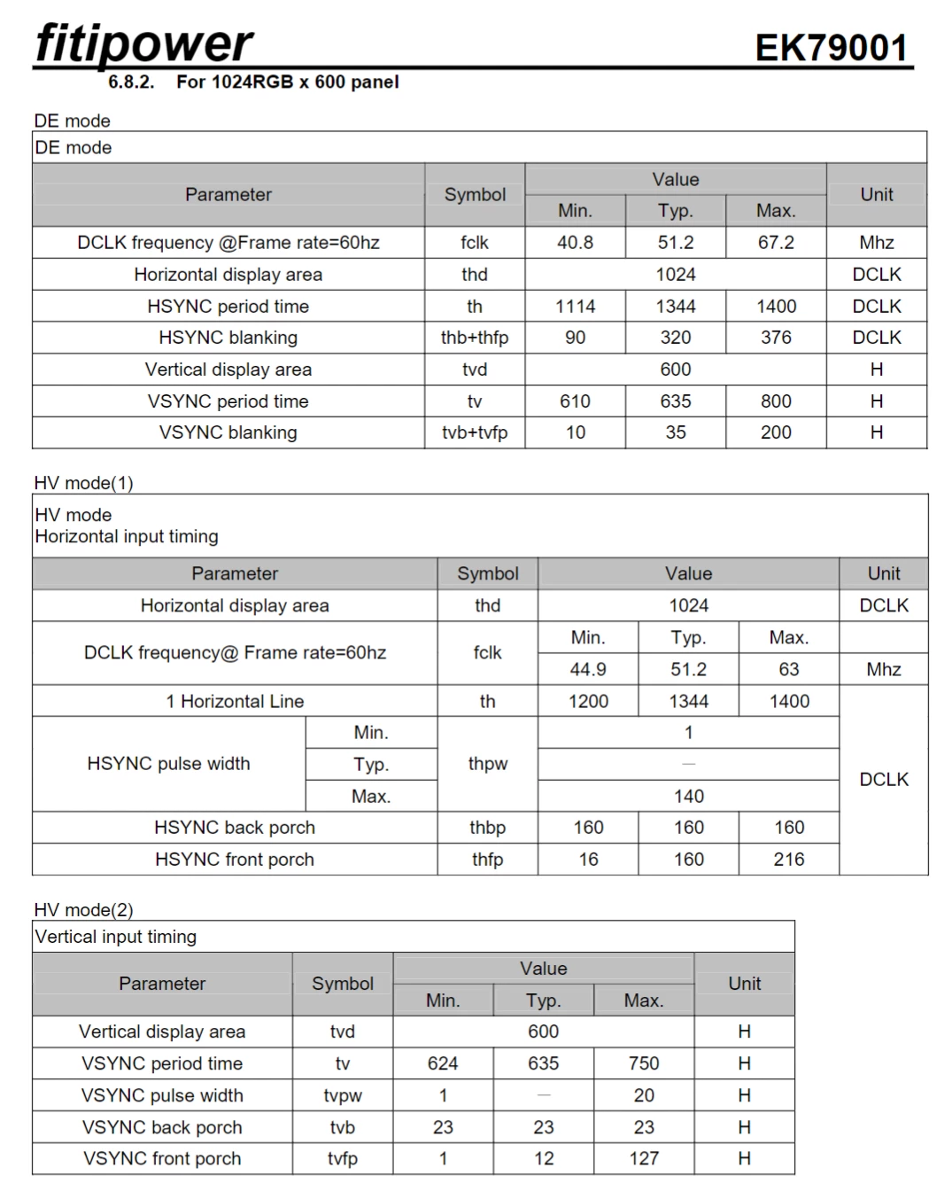

I have tried many times to configure touchGFX with cubeMx, and I was finally almost successful. My screen is 1024*600, and the driver chip is EK79001.
Now the widgets shown on display are distorting(the image seems right), as below:
0693W00000aJs4xQAC.jpgBut my designer is the following:0693W00000aJs57QAC.jpgthe LTDC parameters and the datasheet are as below:
0693W00000aJs5lQAC.png0693W00000aJs6KQAS.pngI really don't know, why this happened, could you help me?
Thanks a lot.

Tesla DeLorean
Guru
Mar 29, 2023 6:38 PM UTC
Looks like the X and Y axis are switched.
ie it is generating the raster with one expectation, and the display has another expectation

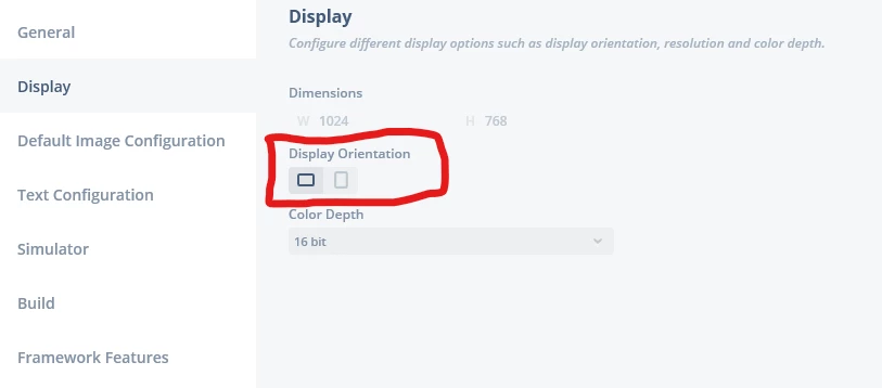

Mar 30, 2023 1:35 AM UTC
@Community member​
Thanks for your reply.
I also doubt that may the X&Y axis are switched.
So I also change the X and Y by config the "Display Orientation" in touchGFX.
0693W00000bhA3OQAU.png0693W00000bhA3JQAU.pngBut this seems nothing to help, the result is the same as before.
(I want to make sure that changing the "Display Orientation" config is the same as changing X & Y axis, am I right?)
Anyway, thanks for your help.

I am using the same LCD controller.
I think you made a mistake on your LTDC setting.
Horizontal Synch Width: 1px
Vertical Synch Height: 1 line
Your other LTDC settings are the same as mine.
Just be aware that with a 1024x600 screen, you are at the limit of what the LTDC and SDRAM can do.
My setup:
STM32H743 @480MHz
LTDC @51.2MHz.
32bit SDRAM @120MHz
I had to use RGB565 instead of ARGB8888 or I would get shaky frames.
I hope your SDRAM data width is 32bit or you will get half the bandwidth and may have to reduce the refresh rate.
Franck.
