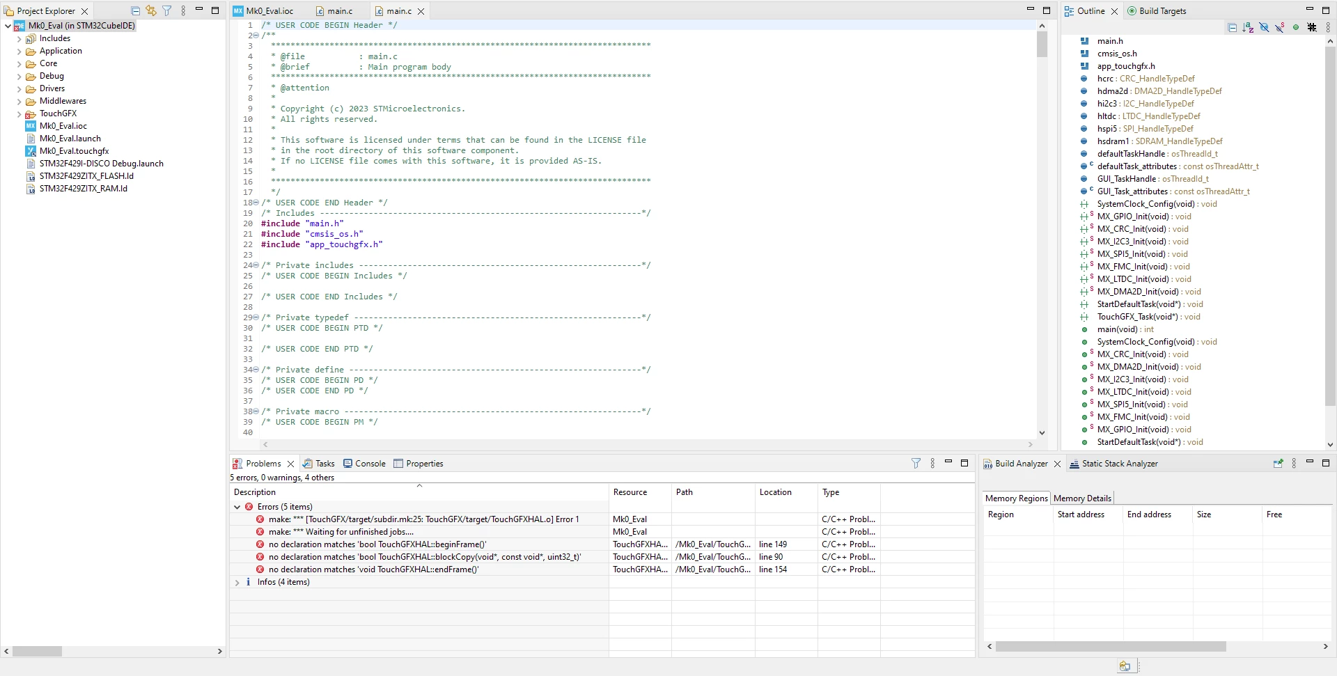

MBode.2
MBode.2Author
Feb 6, 2023 1:14 PM UTC
@Community member​
I have managed to handle the full renaming etc. So thank you for that. It does seem that this should be an auto generated but never the less i have reached that point.
However I am still getting errors when I load the .ioc file up and then generate the code. I have attached the screen shot that you can see below.0693W00000YA4BeQAL.png
Do you have any previous experience of this or how to fix it?
