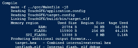

Why external FLASH is used even there is a space on the internal
I am testing a demo of my TSD TSS012004A-AD board.
It has 36KB internal RAm and 256KB internal FLASH.
My configuration on touchGFX like below:
And my linker result is like below:
As you can see there is still %55 empty on my internal FLASH and very little SPI_FLASH is used, I would like to use only internal memory. Why this 13388B is not used on FLASH, even I force to use internal flash section on touchGFX settings.
Thank you,

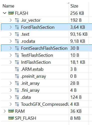

Feb 18, 2026 12:06 PM UTC
Just edit this part of the linker file (STM32C091XX_FLASH.ld):
FontFlashSection :
*(FontFlashSection FontFlashSection.*)
*(.gnu.linkonce.r.*)
. = ALIGN(0x4);
} >SPI_FLASH
to:
FontFlashSection :
. = ALIGN(0x4);
} >FLASH
Result:

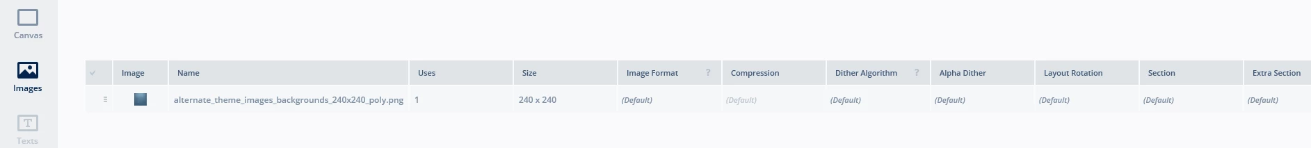

Feb 18, 2026 10:43 AM UTC
Hello @JohanAstrup,
Thanks for the quick response, yes, I know 256KB is not a lot, but 128KB is still empty, so I would like to use that space instead.
On the tab of images, I have already checked all selected default, and even I select the "IntFlashSection" it is same.
I realized that that, the data on SPI_FLASH is the font. There is no option on touchGFX or somehow I cannot see that, I cannot force to put the font data on internal memory,
I think only data on external FLASH is the font, I`ve changed my font size to be sure, and realized the used memory is decreased..
So, what do you think, what should I follow next? I attached my project.
By the way, there is a demo project on touchgfx (Knob Lite), uses internal memory only even that demo has more images, allocated spaces than me..

Feb 19, 2026 9:46 AM UTC
Hi @unsigned_char_array
Thanks for the fix, it resolved the issue, now there is no data on the SPI_FLASH as I requested, but this time, I cannot print any text on the display regardless of the font, size, type etc.
Do you know is there any root cause might cause font cannot be displayed?
Edit: Under the text configuration config window, the "Mapped storage format option" must be selected, so with this selection resolved my issue.
