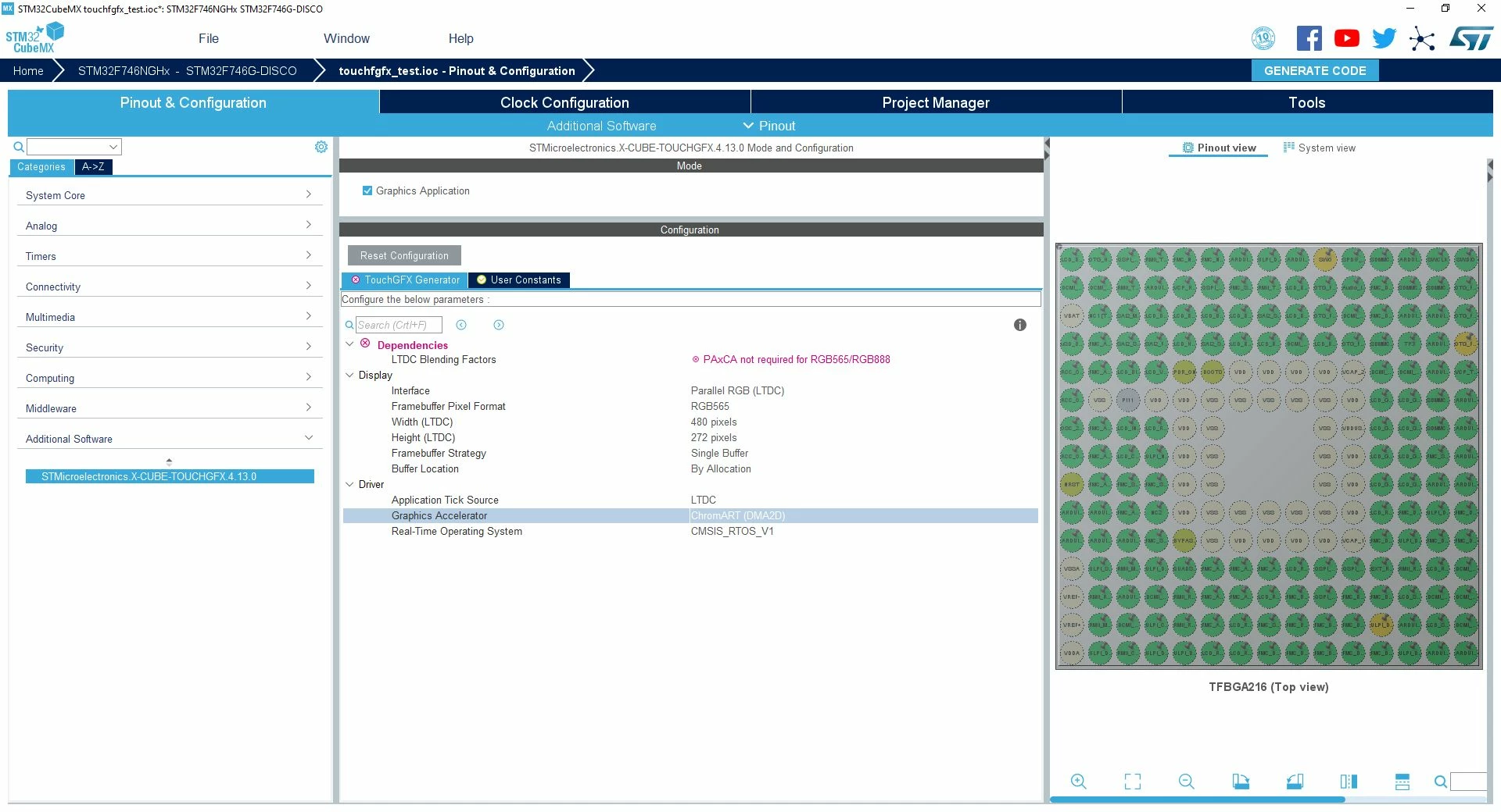

Karl Yamashita
Principal
Jan 8, 2020 2:46 AM UTC
So this new 5.5.0 shows it is RC6 dated 12-30-2019 and the 5.5.0 that i got from ST support is dated 12-20-2019. They both show an error as shown in the image. I have tried different combinations using the drop downs but i can't get rid of the error which prevents me from generating a project. How do you start TouchGFX from CubeMX? I have both TouchGFX 4.12.3 and 4.13.0 installed. What am i doing wrong?

Martin KJELDSEN
Principal III
Jan 8, 2020 11:58 AM UTC
It's not an error. It's a warning to say that you do not need this particular blending factor for your LTDC layer.
