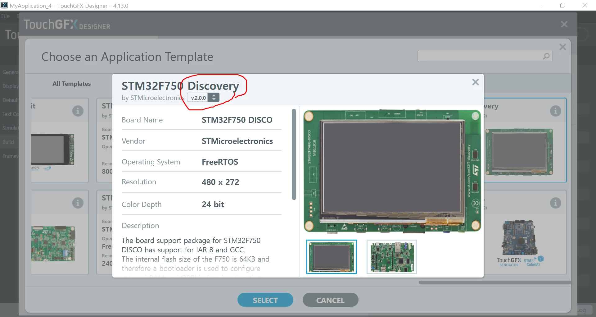

YKim.11
April 13, 2020
Hello Martin​,
Thank you very much to the solution to the question.
It worked fine as you suggested
after modifying it in the config Tab.
​But what does "V3" mean in Application Template?
(TouchGFX 4.13.0)
Would you let me know it ?
