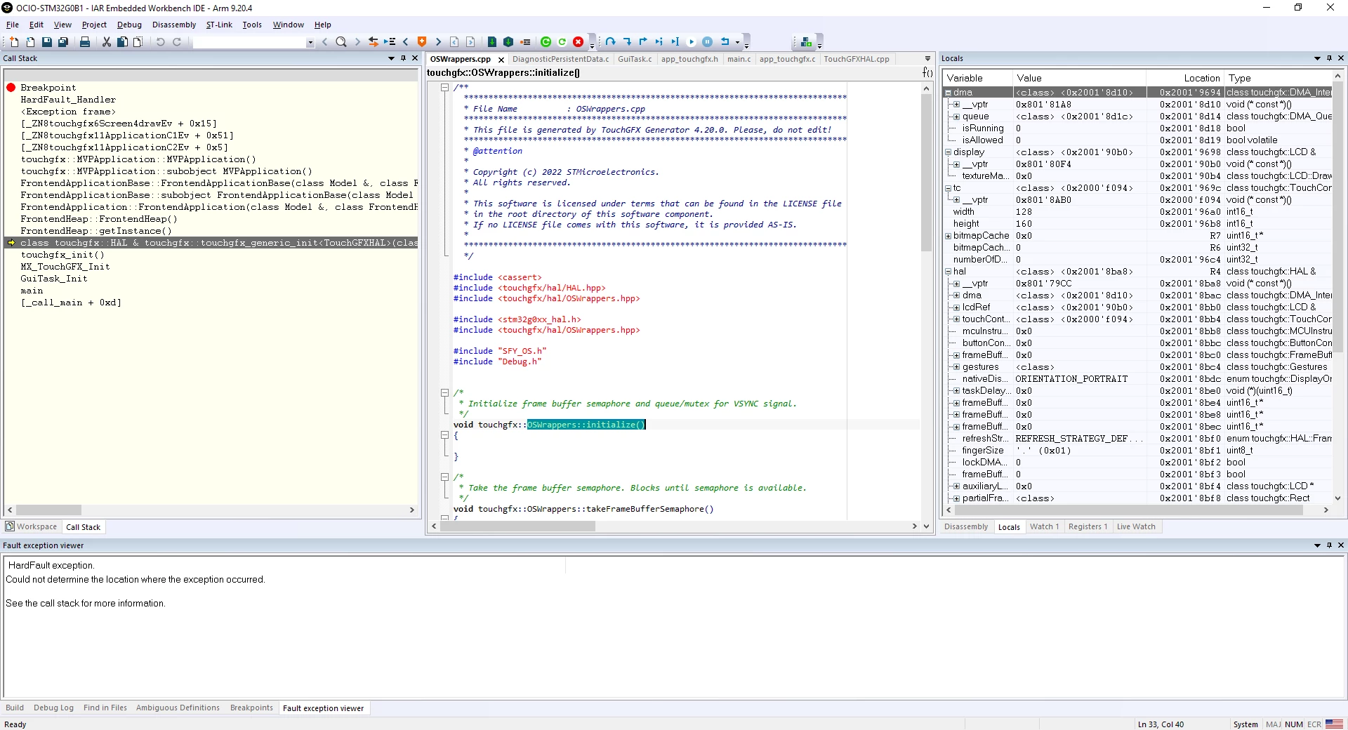

Why does a HardFault_Handler occur in my touchgfx_generic_init on calling FrontendHeap::getInstance()?
I have a problem during my touchgfx_generic_init call.
I fall in HardFault_Handler when FrontendHeap::getInstance(); is called.
Before that I have a strange behavior on calling hal.initialize(); which calls OSWrappers::initialize() and switch to disassembly code.
You can have look on the print screen joined.
Thanks for your help.

Do you have the CRC enabled ? It is mandatory to initialize the TouchGFX library, please see the following post : HardFault in MX_TouchGFX_Init() (st.com)
