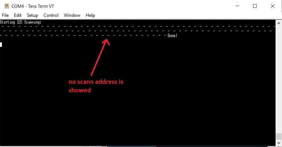

Hi every one. I am using STM32-F401RE, 2x16 LCD with I2C integrate, i connect SCL-SDA-Vcc and GND each other (board and LCD), i tried to make scann program to know adress of LCD in this way:

but no adress i saw. If i use LCD with Arduino Mega board i am able to see the 0x27 adress of LCD. I used also all the pins avaiable on F401RE board for SCL and SDA comunication but never i see the adress of LCD.
Have some one idea how i can get it(adress of LCD)?

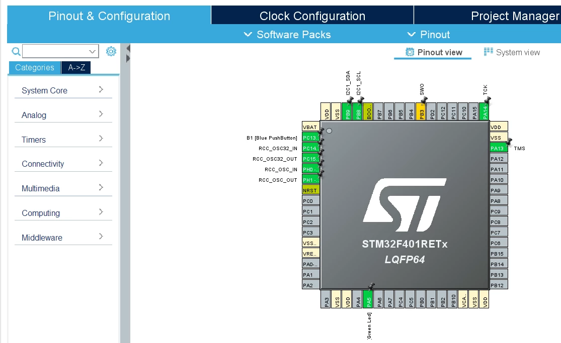

Hi, I bought the F401RE Nucleo board on Amazon, I used it for several project and no issue to here. When i tried to connect thos boaard to 2x16 LCD with I2C drive integrated to LCD, i wasn't able to send any letter from board to LCD. The lcd work because i used it on arduino and i see on lcd some letter like : hello word. I create a progect in CUBE IDE, left the standard configuration, i wrote this code in main:
int main(void)

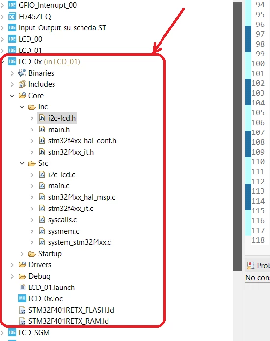

I add two library, this:
First libray:

I supply the LCD with 5 V of the board. I didn't found any tutorial on web using this F401RE Nucleo with LCD but only other kind of STM32 board. Maybe this board have some issue in this kind of application?
I tried to use all possible SDA/SCA pins canghing the IC2, IC3 but nothing working. Attached some pictures of my project. I used arduino mega and there working.
If some one can help me i can send the entire project.

Illustrate your wiring. Prior post only has a single picture, not pictures
