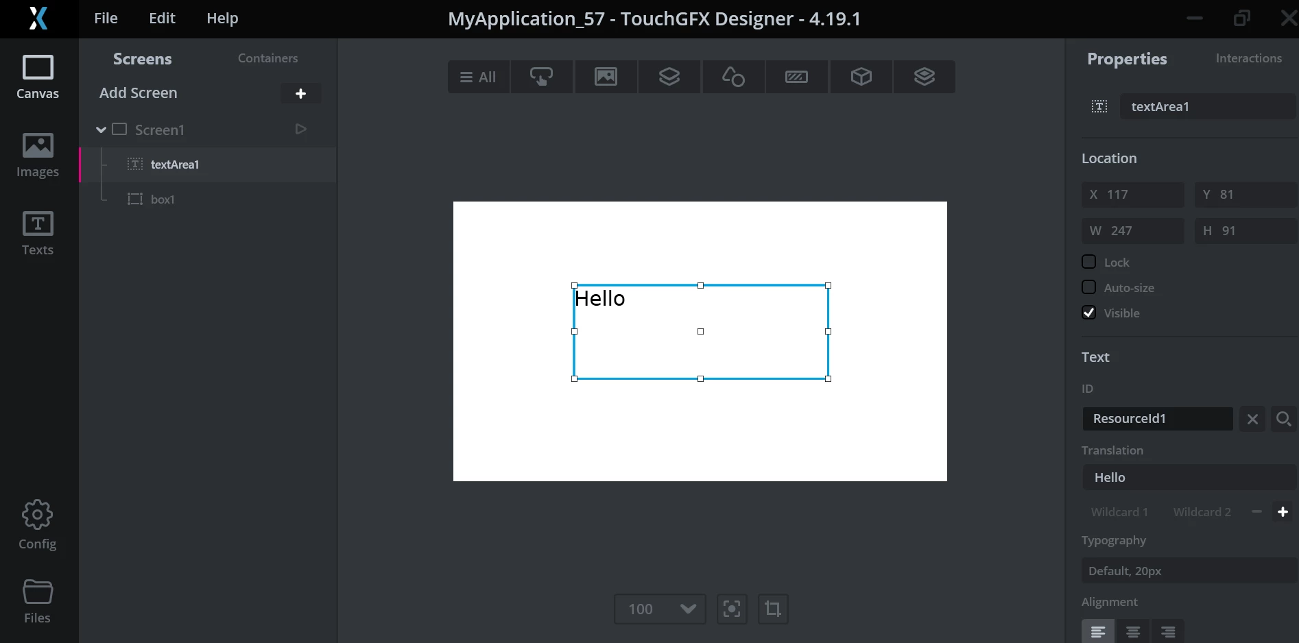

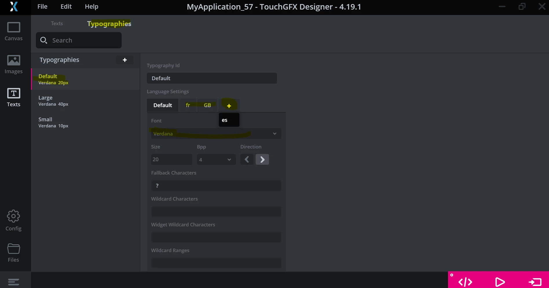

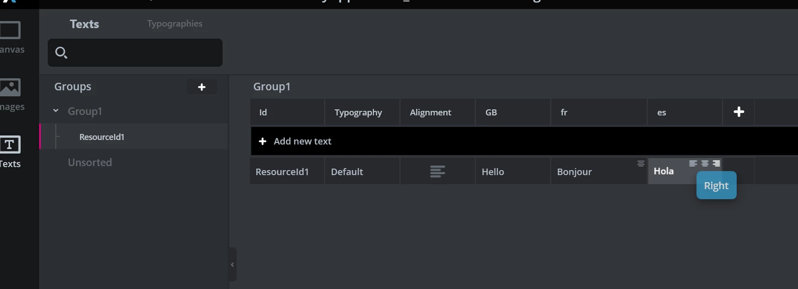

Yes I think you're missing something :) Actually we do have in TouchGFX Designer the option to have different alignments and fonts for each of your translation of your same resource.
Here is how to use it:

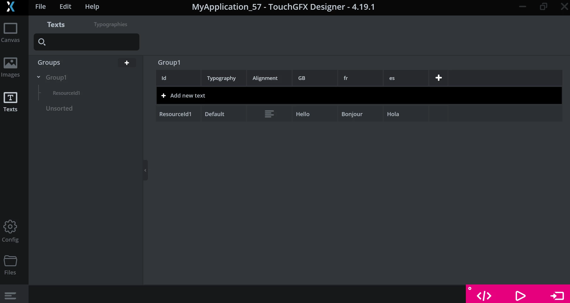

1- Create a new resource on Designer with different translations

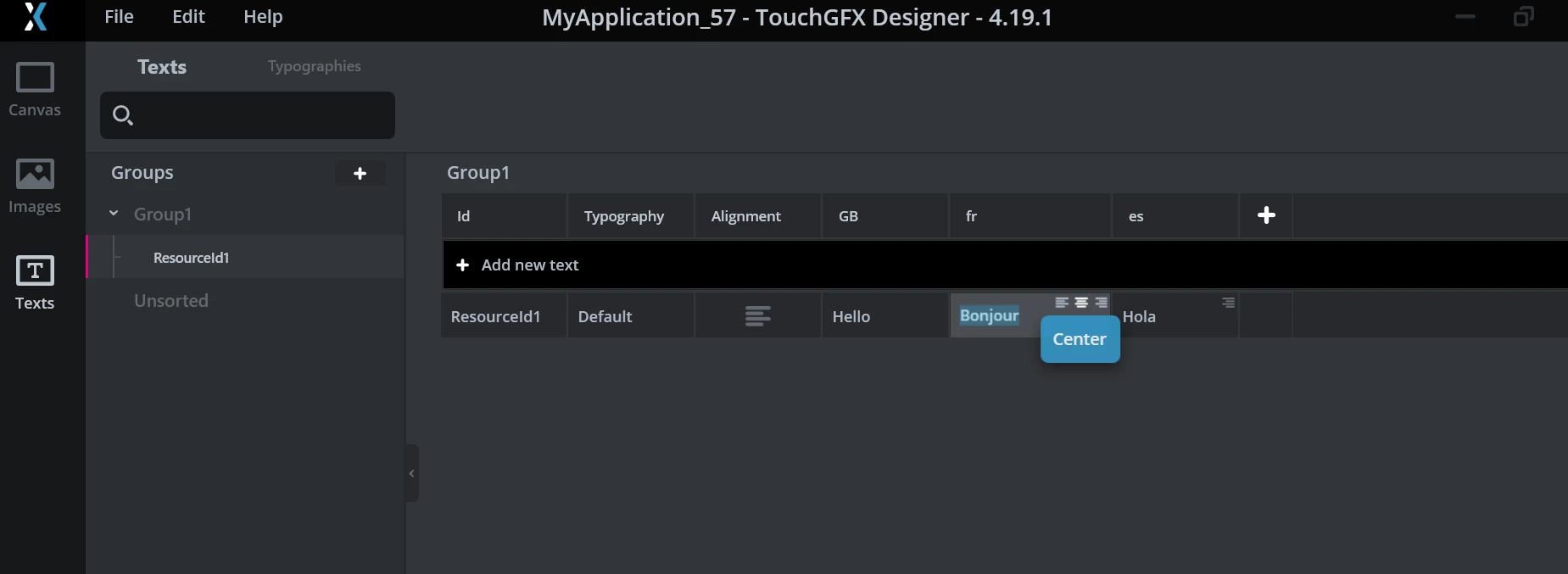

2- If you want to change the alignment, double click on the translated resource and change the alignment

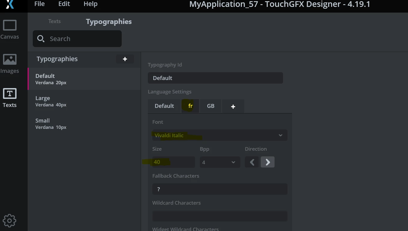

3 - If you want to change the font of your translated resource, go to the "Typographies" tab and click on the Typography you want to use, then click on the "+" logo to add the languages you want to change the font, and select another font.

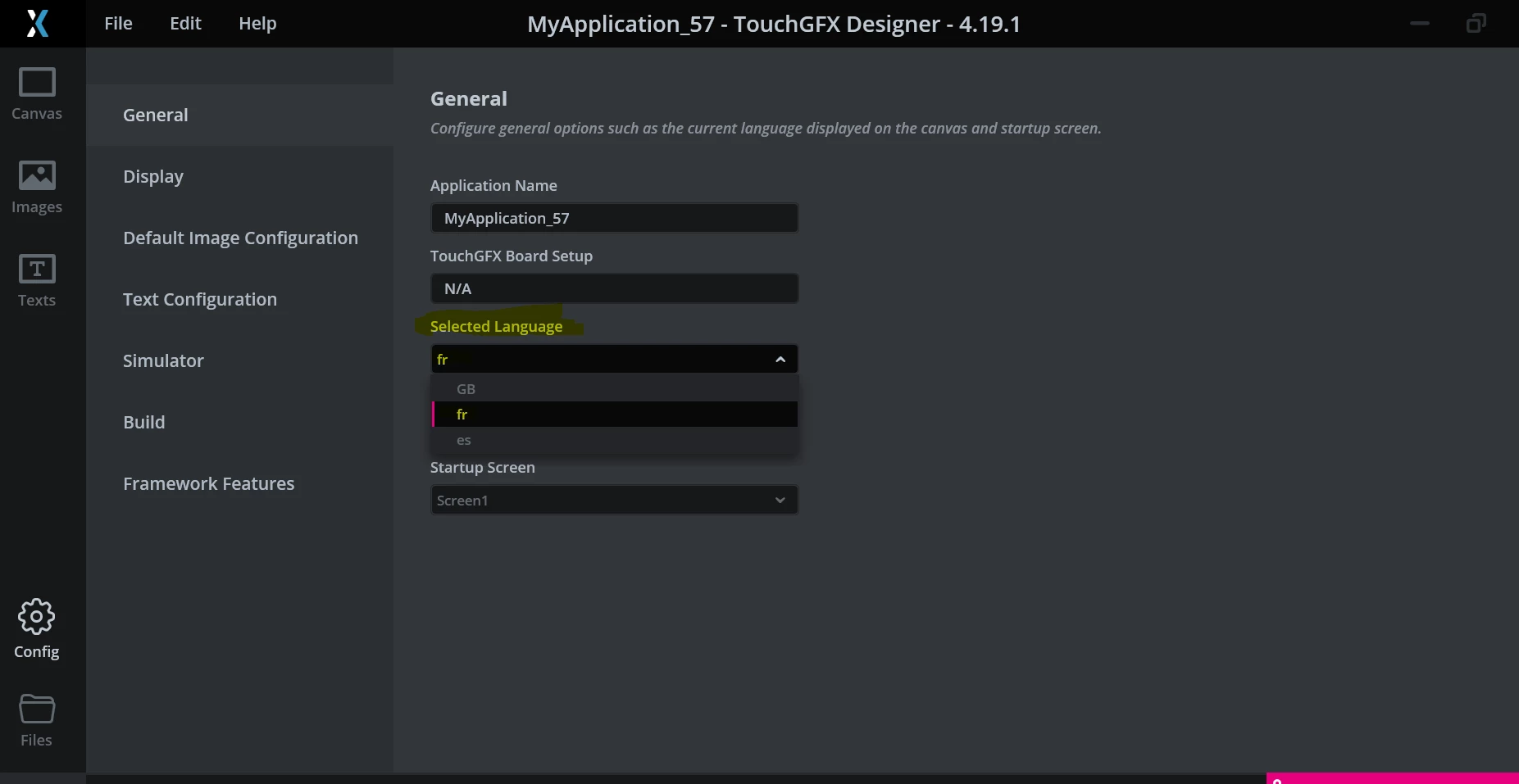

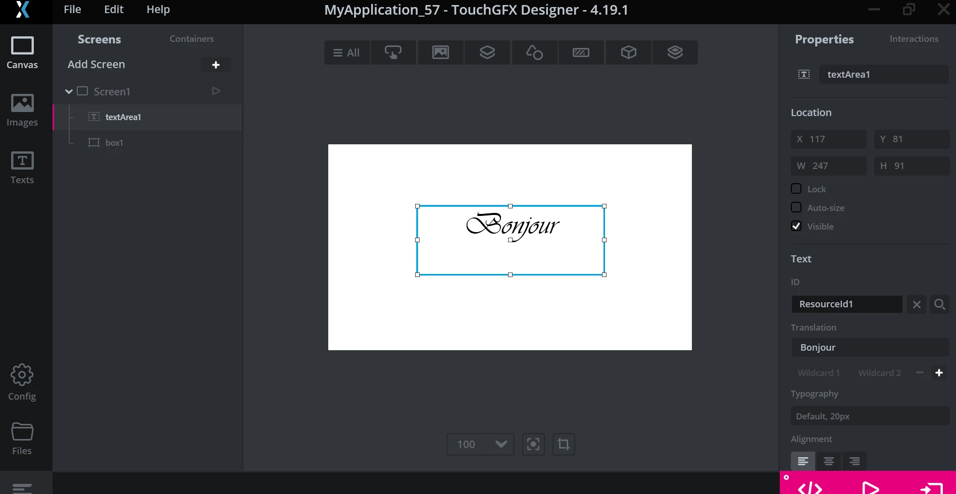

4 - Now, if I change the language of my application (Config > General > Selected Language), my changes should be applied to my resource.
Hope this helps :)
