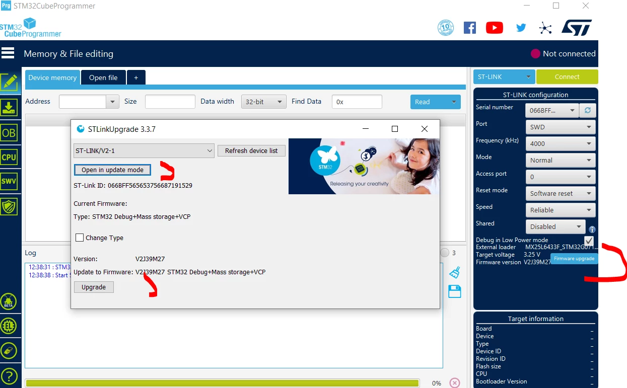

Your project works fine on the board I have. Could you check with STM32CubeProgrammer if you have the latest firmware ? Could you share which version of the board you are using so that I can compare with mine? You should see a white tape with something similar to this written on it: MB1189 B-03, which means that my board is revision B-03.
