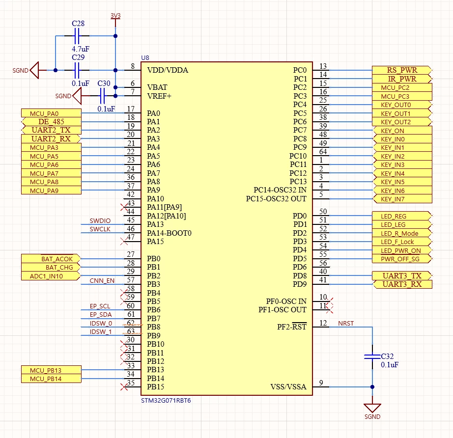

I made a custom STM32 board based on the schematics of Nucleo-G071RB and X-Nucleo-GFX01M2. On the development board, the TFT LCD works. However, when I program my custom board using STLINK-V3SET, the TFT LCD only shows a white screen.
I did changing TFT LCD(DT022CTFT) : new TFT LCD just same.
this is my custom board's MCU.
This is my custom board's SWD pins

    oh.... I forgot DISP-NRESET is not PA1 in my circuit. (X-NUCLEO-GFX01M2's DISP-NRESET is PA1)
    I change DISP-NRESET pin to PA4, and working fine
