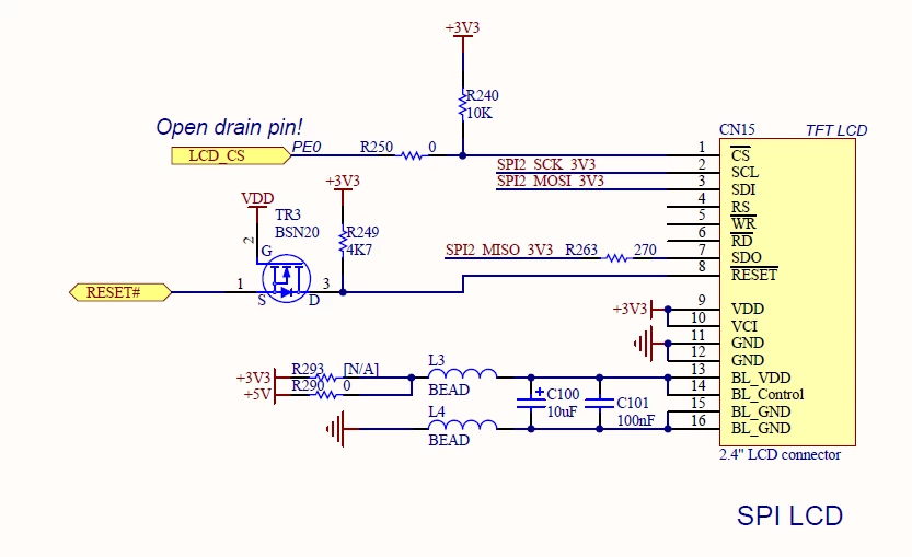

which lcd is mounted on the STM32303E-EVAL board ? How do i get to know its model number and are there any example programs to run it with ?

Foued_KH
Mar 21, 2023 3:20 PM UTC
Hello @CJaid.1​ ,
240x320 TFT color LCD connected to the SPI interface.(user manual : UM1807 section 2.20 Display and input devices)
You can refer to this link. It contains lcd libraries.
Foued
CJaid.1
CJaid.1Author
Mar 21, 2023 3:25 PM UTC
Hello.
Yes, I have the BSP and the user manual, but there is not much data about the LCD and what is the part name/ model number of the lcd so that i can use the respective bsp file.
Also, are there any sample programs where i can get some examples.
Foued_KH
Mar 21, 2023 4:05 PM UTC
It's a 240x320 TFT LCD with SPI.
Tesla DeLorean
Tesla DeLoreanBest answer
Guru
Mar 21, 2023 4:22 PM UTC
Aren't the part numbers called out in the Bill Of Materials (BOM) under the CAD Resources tab of the product page?
8001049,1,LCD 2.4 inch 143.6mmx85.5mmx4.34mm,CN3,,,"AMPIRE CO.,LTD",AM240320LGTNQW-00H,,,,,,ST,lead free,,serial
8001050,1,LCD 2.4 inch 143.6mmx85.5mmx4.34mm,CN3,,,"AMPIRE CO.,LTD",AM240320LGTNQW-01H,,,,,,ST,lead free,For all products except STM32L152D-EVAL,parallel
8001038,1,LCD 2.4 inch 143.6mmx85.5mmx4.34mm,CN3,,,"AMPIRE CO.,LTD",AM-240320LDTNQW-05H,,,,,,ST,lead free,For STM32L152D-EVAL only,parallel
https://www.eurocomposant.fr/pub/media/pdf/AM-240320LGTNQW-00H-A.pdf
https://www.ampire.com.tw/en/index.asp
