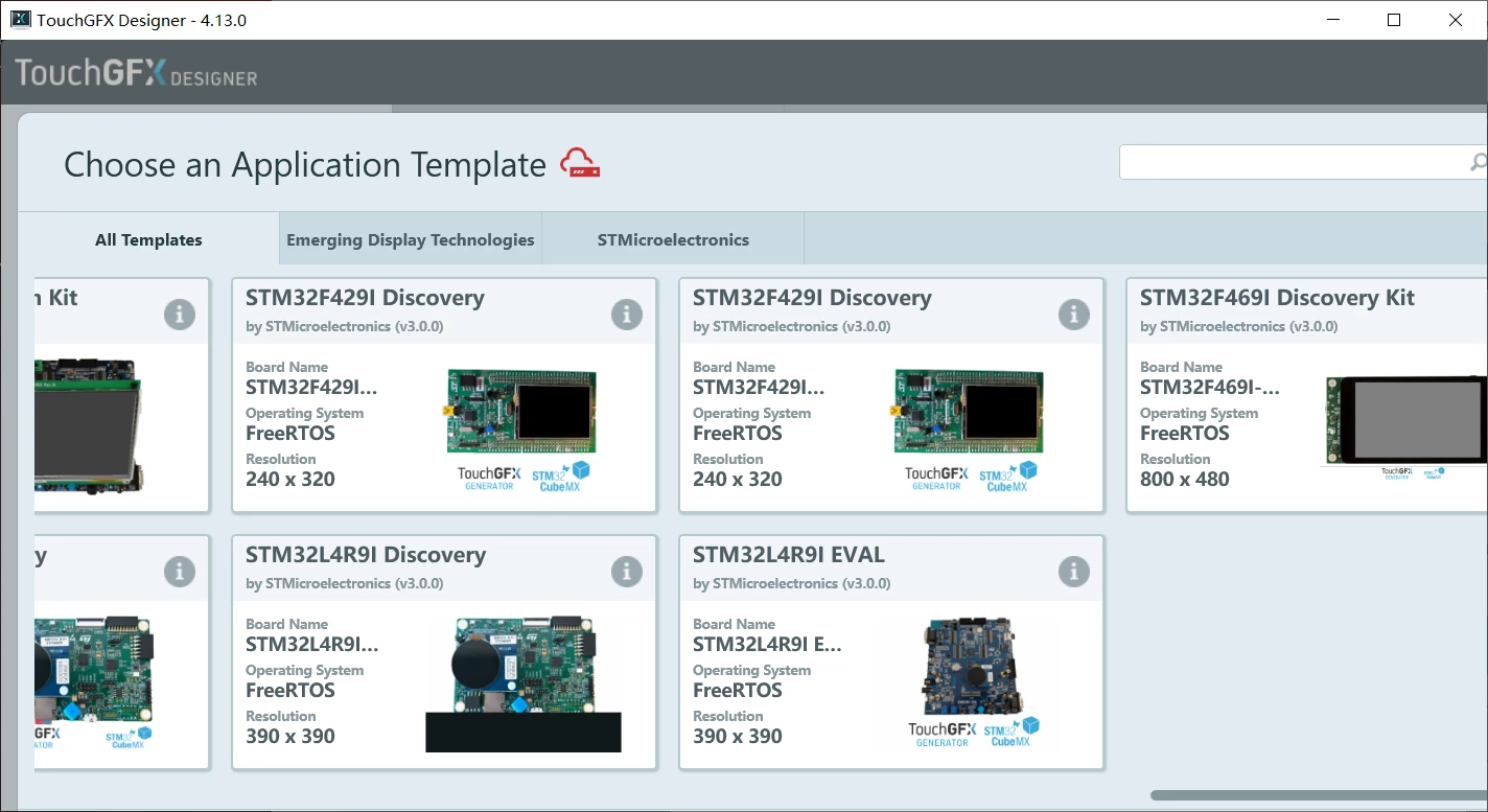

Why are there two F429

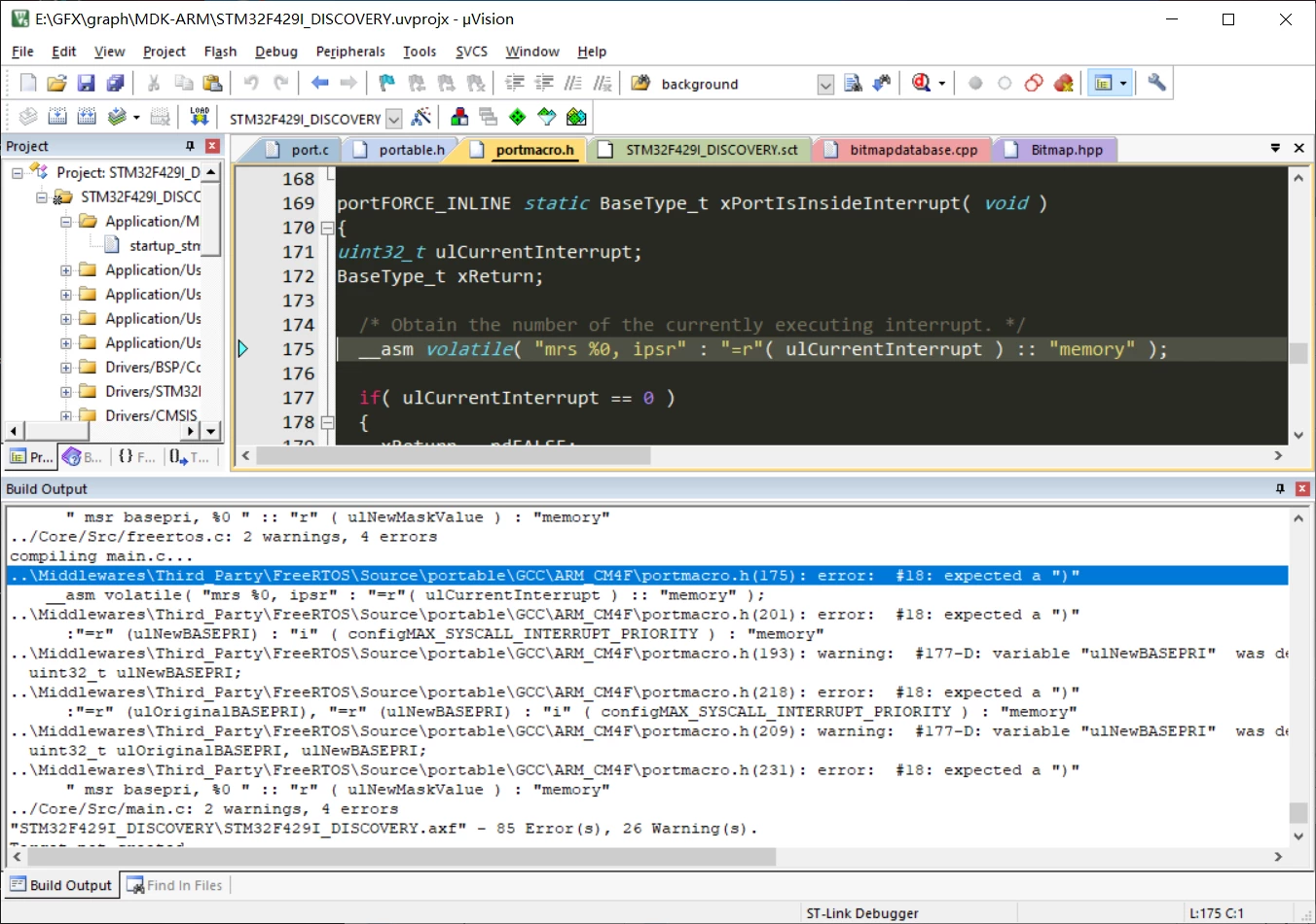

The generated code will also report errors.

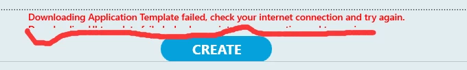

The 2x 429-disco does look strange, but it's not an issue i'm seeing here. I'm noticing you don't have a proper connection (red cloud) to the package server. Can you check your connection and try again?
The compilation errors are from FreeRTOS code - You may be using a compiler that is not supported by some version of FreeRTOS. Which ARM compiler did you select?

​I can easily download any UI template using PC,but can not download any UI template using application template.
