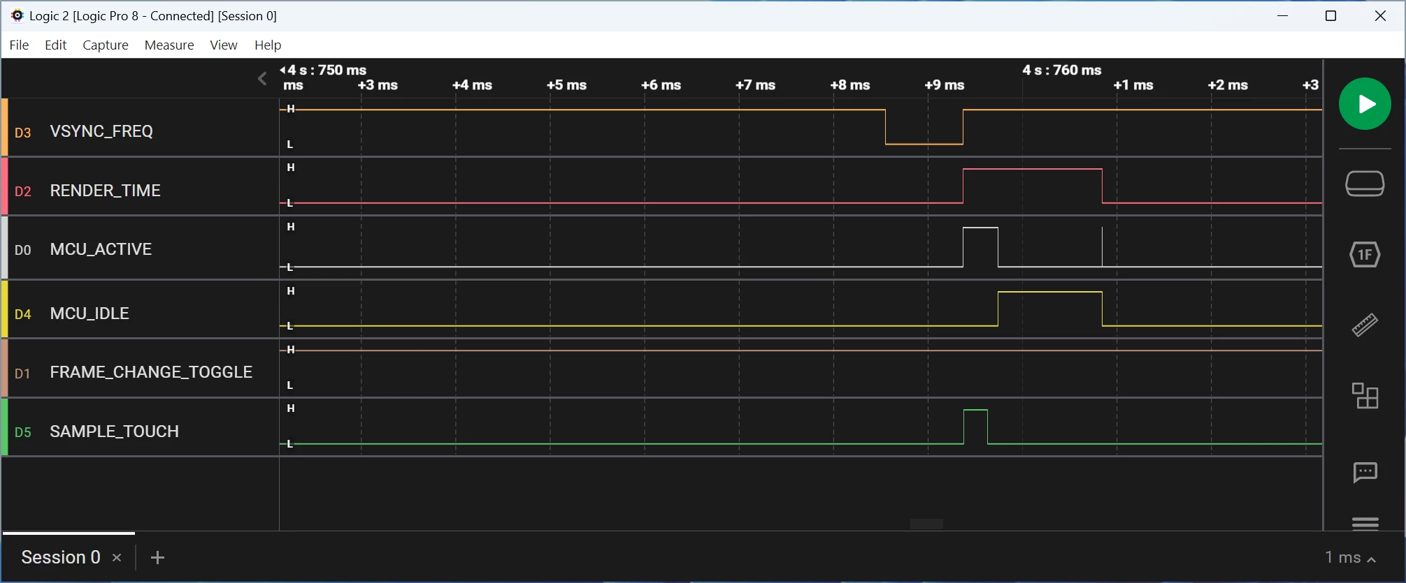

I have a similar question and I didn't find the provided answer to my satisfaction. I'm using the STM32H735G-DK development board and I have modified the project to work without FreeRTOS (I've attached my oswrappers). It works, but I noticed only MCU_ACTIVE is NOT set by TouchGFX. If I set it while backPorchExited is being called, then MCU_ACTIVE behaves exactly the same as RENDER_TIME. If I check the documentation I see something different:
https://support.touchgfx.com/docs/development/touchgfx-hal-development/scenarios/scenarios-measure-performance#performance-metrics
MCU_ACTIVE can become low during parts of the RENDER_TIME in this example.
I use isVSyncAvailable() and when false I run my own code in the loop. Only when isVSyncAvailable is true I call backPorchExited (during which I set MCU_ACTIVE). Higher priority "tasks" are run in a timer interrupt (and they quickly finish in a few cycles) or peripheral interrupt.
taskYield and taskDelay are not called. But I did notice that if I push a button takeFrameBufferSemaphore is waiting for a semaphore to be available. If I clear MCU_ACTIVE there and call my own idle function I get the same pattern as in the example (I also added an MCU_IDLE signal during this waiting time). However I still wonder why this is happening inside the library.
So my questions are:
  1. why is it waiting for the buffer to be available again? Is it copying graphics using a DMA? Is it waiting for some type of interrupt? Obviously it's waiting for something without using the MCU core.
  2. when is the LTDC writing to the display? Is this during the high or the low part of the VSYNC_FREQ?
  3. I noticed the following article talks about hooks that are available at different stages of rendering. I didn't find those anywhere. Where can I get access to these hooks? https://support.touchgfx.com/docs/development/touchgfx-hal-development/touchgfx-al-development-introduction
