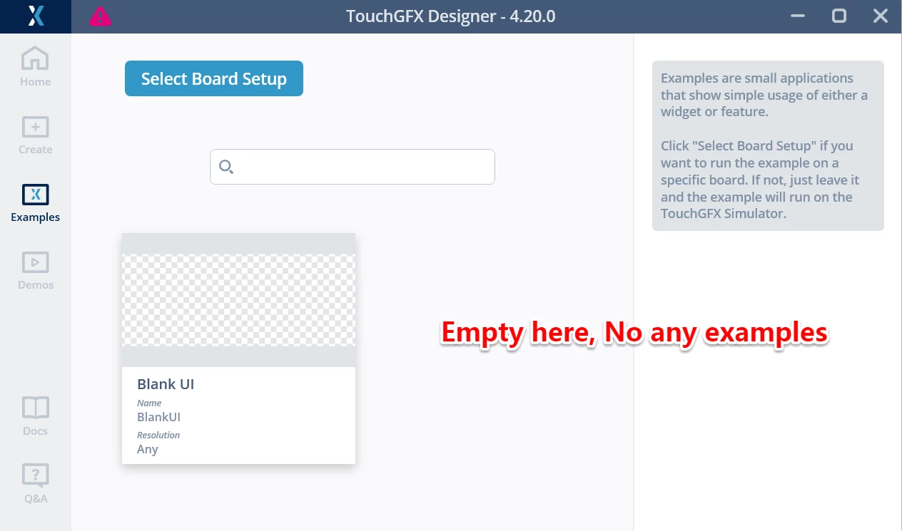

Where is examples and demos? first time I install TouchGFX Designer 17.0, there is examples and demos in left panel, where I learned a lot, but it's actually empty in TouchGFX 19.0,2.0, even I download 17.0 again, is gone? am I missed something?

Hello @Xzhiy.1​ ,
That could be related to your Windows OS version.
If you are using Windows 7 or 8, you won't be able to see demos/examples in TouchGFXDesigner 4.17.0 and more recent versions.
I strongly recommend you to always use the latest version of TouchGFXDesigner (currently 4.20.0) with Windows 10.

Xzhiy.1
Xzhiy.1Author
Jul 12, 2022 8:39 AM UTC
Yoann KLEIN
Jul 12, 2022 9:10 AM UTC
You can see in the screenshot you provided, on the top left corner, that TouchGFX can't connect to internet.
Did you check your internet connection ?
If yes, please close TouchGFXDesigner, open a browser window, and open TouchGFXDesigner again.
Let me know how it's going.
/Yoann

Hi, Yoann KLEIN, thank you.
Yes, I notice that I'm not connect to Internet, but my Edge can view web, I don't know why, working on it.
