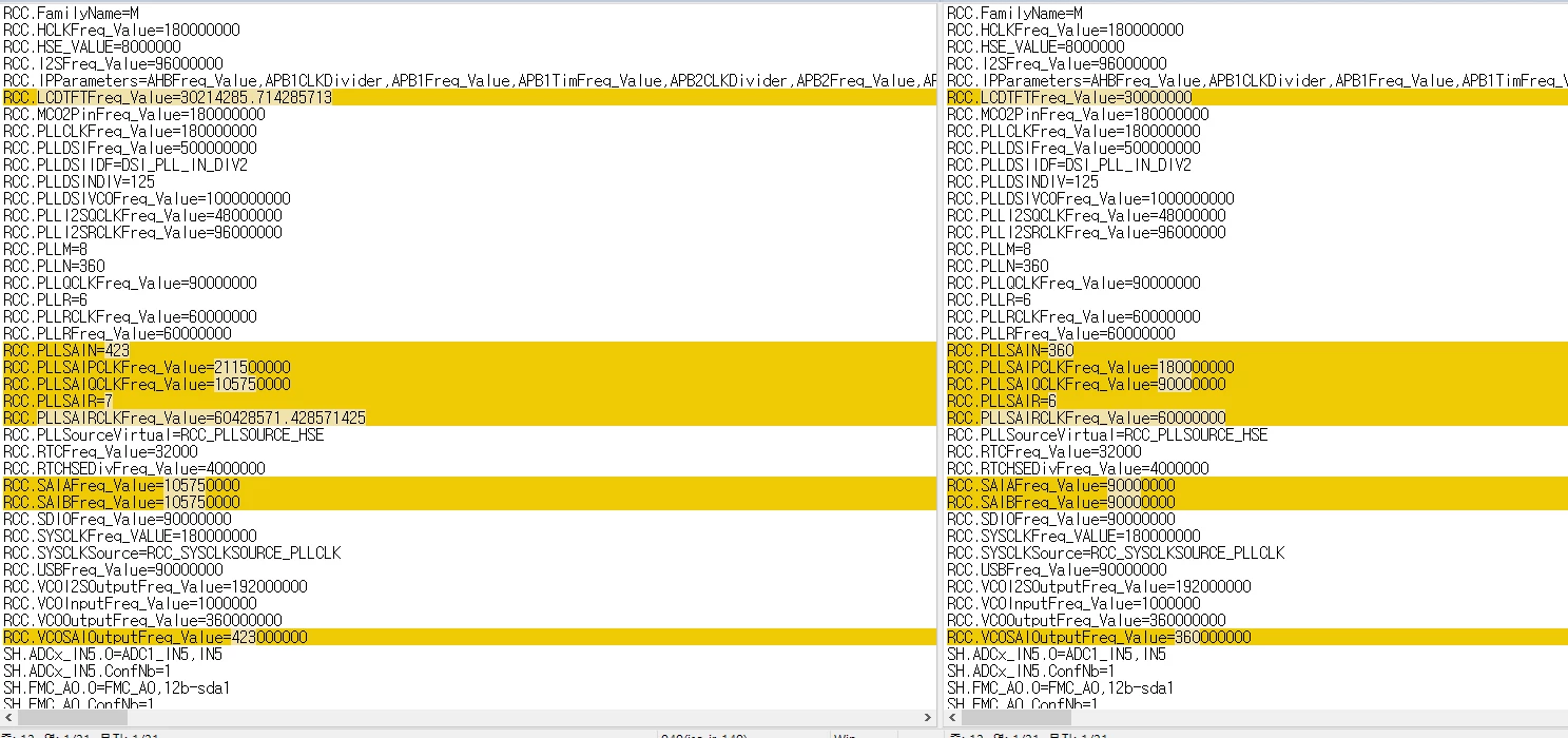

During development on stm32f469i_Discovery, LCD with ILI9806Eic was changed.
There was a problem with LCD display after the change.
Unicode::snprintf(Hour_TimeBuffer, 4, "%02d", mHour_Data);
main_pageView::Hour_Time.invalidate();
On this writing screen, write the changed value on the screen whenever the mHour_Data value is changed.
When writing the changed value, something like an afterimage remains on the LCD screen.
It's a problem that hasn't happened before, but it keeps happening after changing the LCD.
LCD spec is set to Video mode and set to 60 frames. The same problem occurs when set to 40 frames.
I don't know why this problem is happening.
Is it related to the speed used to display data on the LCD and the number of LCD frames?

Development is using the stm32f469i_Discovery board.
The project was created and developed by TouchGFX Designer.
During development, the HW specification was changed, connecting a separate 5-inch LCD to the stm32f469i_Discovery board instead of the stm32f469i_Discovery 4-inch LCD.
The LCD is the KD050FWFIA019-C019A and the controller ic uses the ILI9806E.
The 4-inch LCD of the stm32f469i_Discovery Board is Command with TE, and the 5-inch LCD is Video mode.
The changes in program settings were made to MX_DSIHOST_DSI_Init(), MX_LTD_Init(), and other settings were not changed.
After changing LCD, it seems that the speed of screen switching has also slowed down a lot.
All this seems to be related to the system clock, but it's hard to find which part is the problem.
Please let me know if you need more information.
Upload the requested data sheet as an attachment.

LTDC frequency is not the only thing to be changed if you switch to another display, LTDC timings (vertical/horizontal back/front porches, etc.), must also be adapted to your new display's datasheet (this is not clear if you did so in your description)
This is even more important in DSI Video mode as the timing information will directly come from the LTDC (in DSI Adapted Command mode the display controller handles the display panel timing).
Please be also aware that with this new display 854x480 you have a line of 854 pixels, which is not a multiple of 64 bytes either in 16 or 24 bits, this may lead to the issue described in AN4861, section 4.5.2 and lead to visual artefacts.
I hope this will help you in your investigations,
