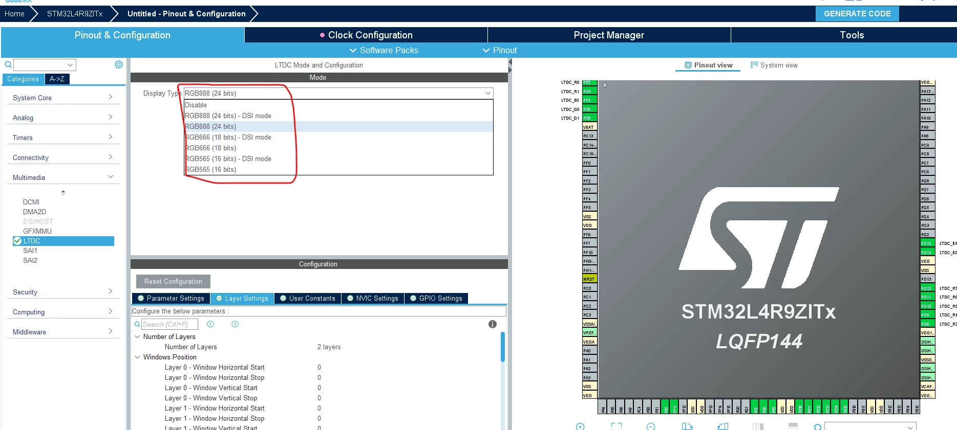

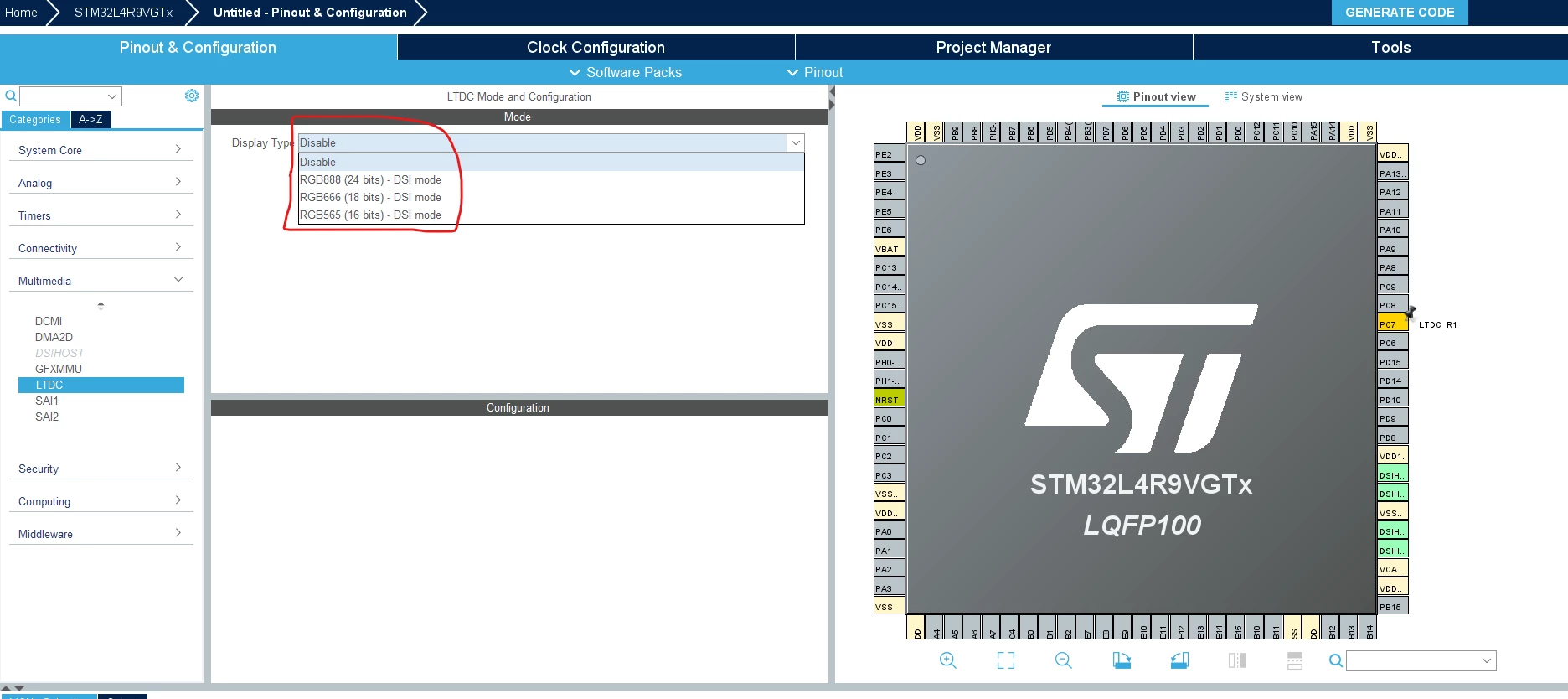

When using stm32l4r9vgt chip in cubemx, ltdc RGB interface cannot be selected?
  • April 28, 2021
  • 733 views
cubeMX version:6.2.1, STM32L4R9ZIT can select RGB interface,but STM32L4RVGT cann't
Best answer by MM..1
Maybe because not all RGB pins is accesibble on LQFP100 package
