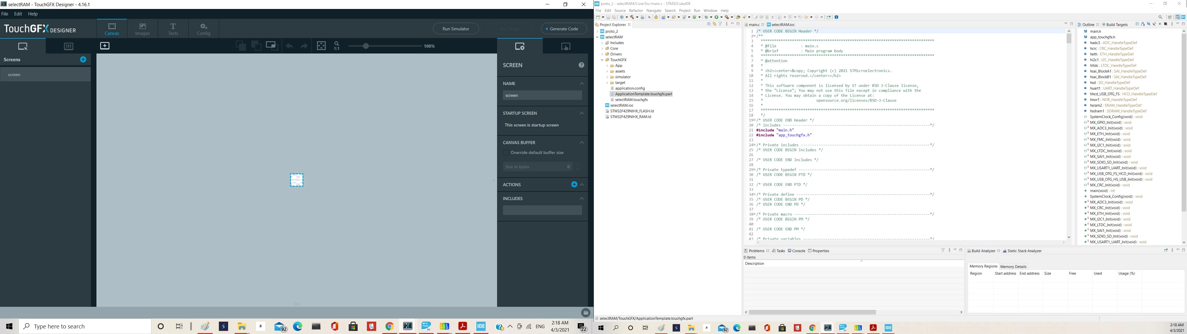

when i start the designer from stm32CubeIDE, the canvas is very small in size,

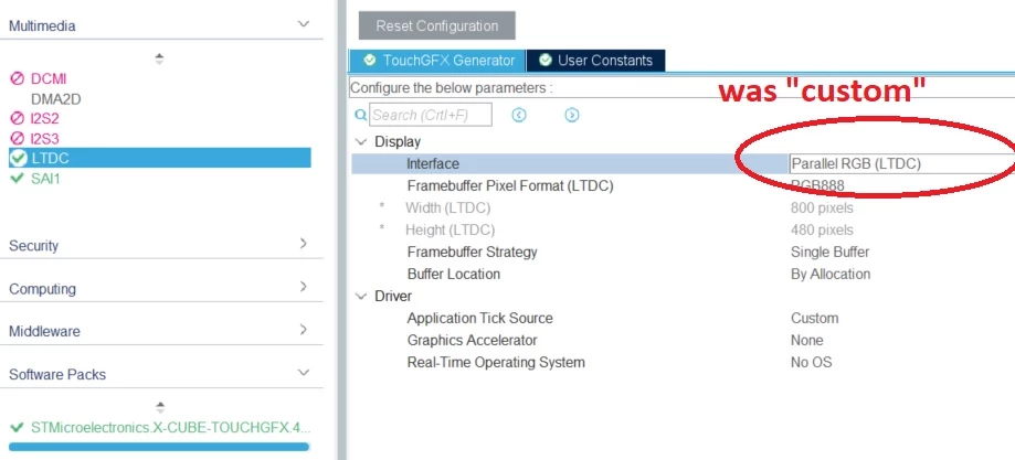

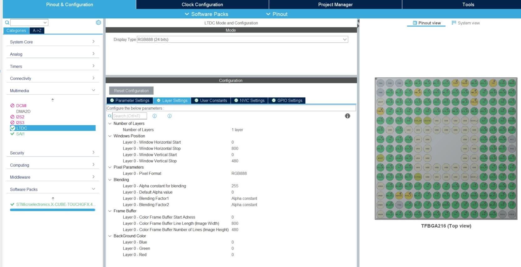

Follow up on my question, please note the LTDC config screen:
ksale.1
ksale.1AuthorBest answer
Senior II
April 3, 2021
I figured out the problem. It was the Display Interface mistakenly left at "custom" instead of "Parallel RGB (LTDC)". I apologize for any inconvenience. Thank you.
