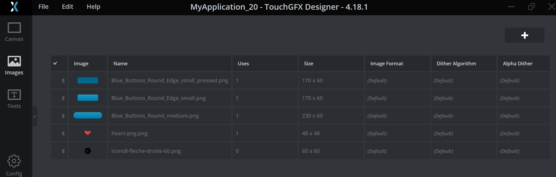

When I copy a png file from another project and they try to use it I get an error message. Not sure why.
  • January 28, 2022
  • 1 reply
  • 693 views
Failed to copy file:
C:\TouchGFXProjects\P51NG\CM7\TouchGFX\assets\images\gauge01_needle.png to C:\TouchGFXProjects\P51NG\CM7\TouchGFX\assets\images
see log for more information

Hi BRobb.1,
Could you give more information about your project please (and add your error logs to this post) ?
According to what you shared, you're trying to copy "gauge01_needle.png" to the same folder.
To add a new resource to your project, I can suggest you to use TouchGFX designer, in "Images" tab, then click on "+" in top right.
