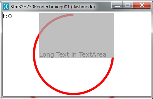

Here is a screen shot from the Designer. The TextArea widgets is inside the big circle widget. The "t:0" TextArea in the upper left corner shows the current frame number.

The first frame looks like this (the whole frame is invalidated):
0690X000009ZcO9QAK.bmp The second frame looks the same:
The reason for this second full update is that I am using double buffering. The whole updates done on the previous framebuffer must be applied on the second buffer also.

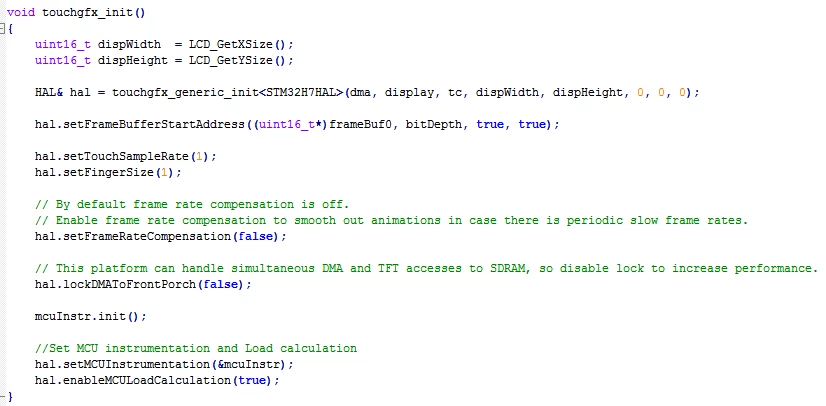

Thanks for your reply. I am using the STM32H750-Discovery kit and have not changed any of the configuration. From what I see in the file BoardConfiguration.cpp, it is set up for double buffering:

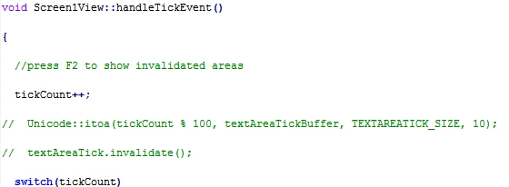

However, I do not think this is the issue. I made a project like yours (including changing the Vsync interval on the simulator). It appeared to work like yours until I did one thing. I commented out the invalidation of the textAreaTick because mine will not have this:
When I did this, I was seeing the same thing that I was with my project (tickCount not being invalidated):
And, interestingly, when I added a textAreaTick to my project, it started behaving as I think it should (alternation of renders).
Why is the invalidation of the textAreaTick aiding the alternation of rendering of the other two items?

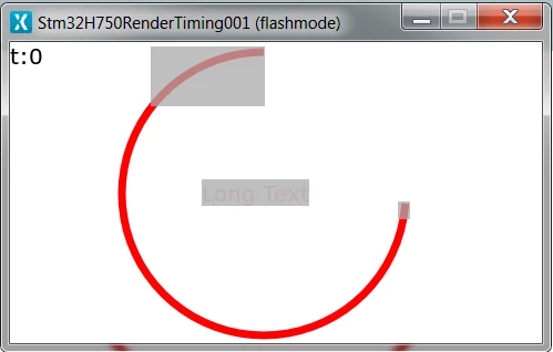

I understand that if it's a big block and overlaps, it needs to redraw all of it. This is the reason I am alternating the invalidation of the different items. The issue I am seeing is that they are invalidating at the same time when they should be alternating. The code is the same exact as yours as I copy/pasted your handleTickEvent() into my Screen1View.cpp file. The rendering alternates as expected. However, If I comment out the invalidation of the textAreaTick, it does NOT alternate but happens at the same time.
I reduced the size of the inside text area to ensure there are no overlaps and ran it again (with the invalidation of the textAreaTick commented out) and as you can see, they are happening at the same time (even with no overlaps):

Yes, if you do not invalidate the TickTextArea in every tick, then you get the TextArea and Circle redrawn in the same frame. This is due to double buffering.
In frame 10 we invalidate the textArea. This causes the textArea to be redrawn in the current framebuffer (call it FB_A).
In frame 11, 12, 13, and 14, nothing is invalidated, so TouchGFX does not draw anything.
In frame 15 we invalidate the circle in both ends. This causes the circle ends to be redrawn in the current framebuffer (FB_B). Since the textArea is not correct in FB_B (was updated in FB_A), it is also redrawn in frame 15.
