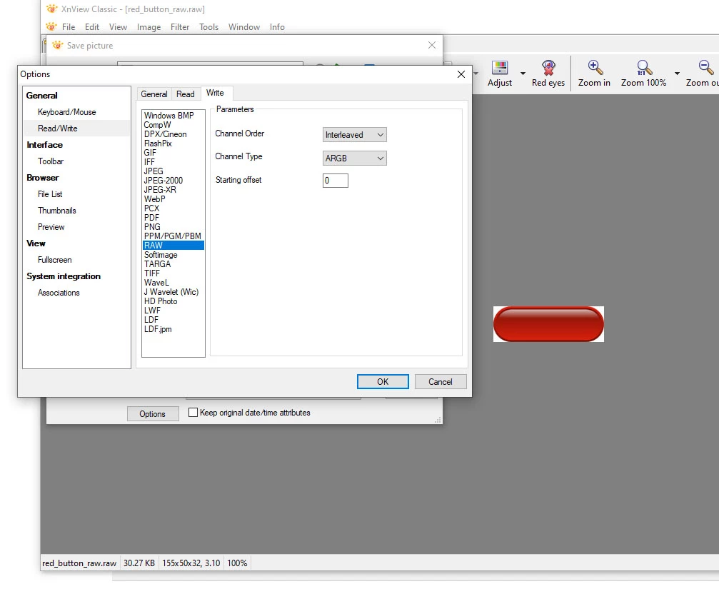

I would use XnView & HxD:
  • Open your image
  • Menu: Image->32bits
  • Save as "RAW" format and before click "Save" you have to click "option" and set "ARGB".

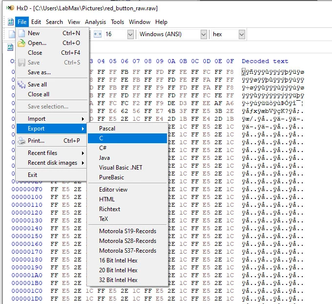

  • Open HxD
  • Open the raw image
  • Export as C file.
It should do the trick.

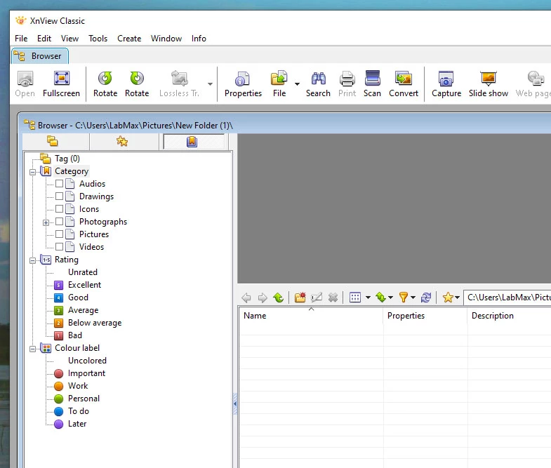

do you mean this program https://www.xnview.com/en/
I do not see the option to choose 32 bit but you can save raw data in ARGB
there is no Menu: Image->32bits
I do not know what you mean by HxD
I am not sure if I read your instructions right.

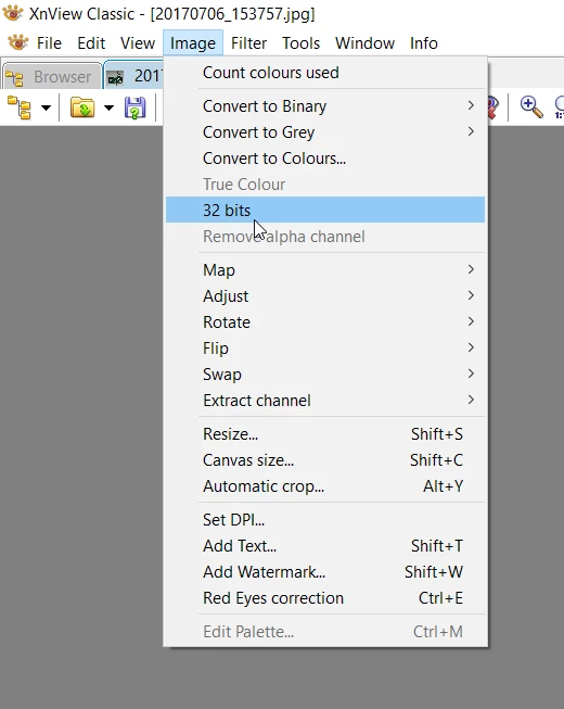

Mike_ST
August 19, 2020
Yes Xnview image viewer.
HxD: https://mh-nexus.de/en/hxd/
32 bits pixel mode should be activated as per following image, I set it to set 0xFF as default alpha value, or you'll get 0 as default, I think.

you must have older version this option is not available in 2.49.3, there is nothing in options, properties, view to add extra tool bar
Mike_ST
August 20, 2020
It is because you have not opened an image in the editor, you are showing the browser.
You have to click File=>Open and select a picture, or select one on the left in the browser.
The 32bits option appears only when a picture is opened.

I did as instructed, I did the 32 bit image, then I open raw image in HxD export as C, and this is what i get
unsigned char rawData[31000] = {
   0xFF, 0xFF, 0xF1, 0xFF, 0xFF, 0xFF, 0xFB, 0xFF, 0xFF, 0xFD, 0xFF, 0xFE,
   0xFF, 0xFC, 0xFF, 0xF8, 0xFF, 0xFF, 0xFF, 0xF8, 0xFF, 0xFF, 0xFE, 0xFB,
   0xFF, 0xFF, 0xFD, 0xFE, 0xFF, 0xFA, 0xFF, 0xFF, 0xFF, 0xF7, 0xF8, 0xFD,
it does not look like the from ST. the ST looks like 32 bit

Mike_ST
August 24, 2020
Ok, HxD doesn't output 32 bits format text, only 8bits. I thought it could do that.
I suggest to write a small C program to open the raw file and output 32bits text,
and copy result in the array.

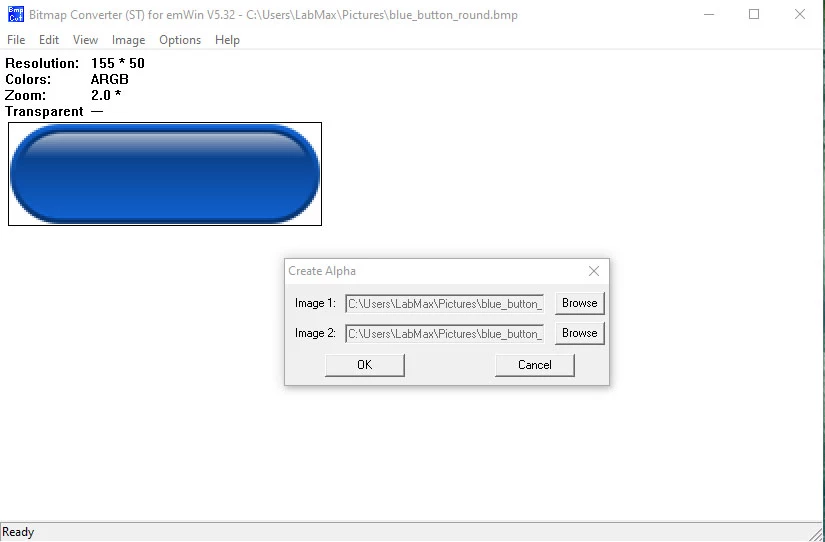

After spending a few days researching I found this program Bitmap Converter (ST) for emWin V5.32 in comes from ST in this package STemWin_Library_V1.2.0
I have to do the Alpha (I choose for image 1 and 2 the same blue button) like on the picture then I get 32 bit ARGB format like this one
0xFF254888,
0xFF254888,
0xFF254888,
0xFF264989,
0xFF264989,
and it finally worked with this code CopyBuffer((uint32_t *)blue_button, (uint32_t *)LAYER0_ADDRESS, 240, 160, 155, 50);

MNapi
MNapiAuthor
Senior II
August 24, 2020
Hey I saw your video a while ago when I was researching, you got the red and blue inverted. Actually I got it first inverted too when I used Bitmap Converter (ST) for emWin V5.32
I had to choose option save as red and blue inverted with alpha, then I get the code right.
