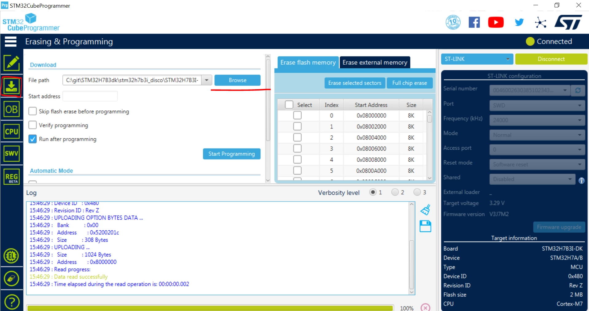

So I developing prototype using STM32F769 Discovery Kit. At first I develop the UI using TouchGFX and so far so good.
But I realize the generated codes from TouchGFX does not really generate driver code for other component e.g. Virtual Component Port. So I search around STM site and found CubeMX tool which seems the right tool for me generate this low level code. So when the code generated by CubeMX, I use Keil IDE vs 5.34. But when I build the code I end up with errors/warning:

Working with Keil will generate a binary that can be flashed on target using STM32CubeProgrammer or ST link Utility. With TouchGFX Designer and with STM32CubeIDE the STM32CubeProgrammer tool is directly used.
In your case after building your project with Keil you will need to open STM32CubeProgrammer. In the picture below I pointed out how to browse to your project folder and select the generated binary. The .hex file "should" be located at  <project_root_folder>/MDK-ARM/<STM32_evaluation_kit_name>/<STM32_evaluation_kit_name>.hex
In order to flash on target you will also need to select the correct external loader.
Concerning the usb_device.h error this is linked to your project.
Concerning the workflow it depends on if you use an application template available in TouchGFX Designer for one of the ST kits, or if you are working on a custom hardware project (or wish to work on a ST development kit but start from scratch). Have a look at the documentation to understand the workflow for developing TouchGFX projects. There are also videos made by ST or other users which could be of interest to you.

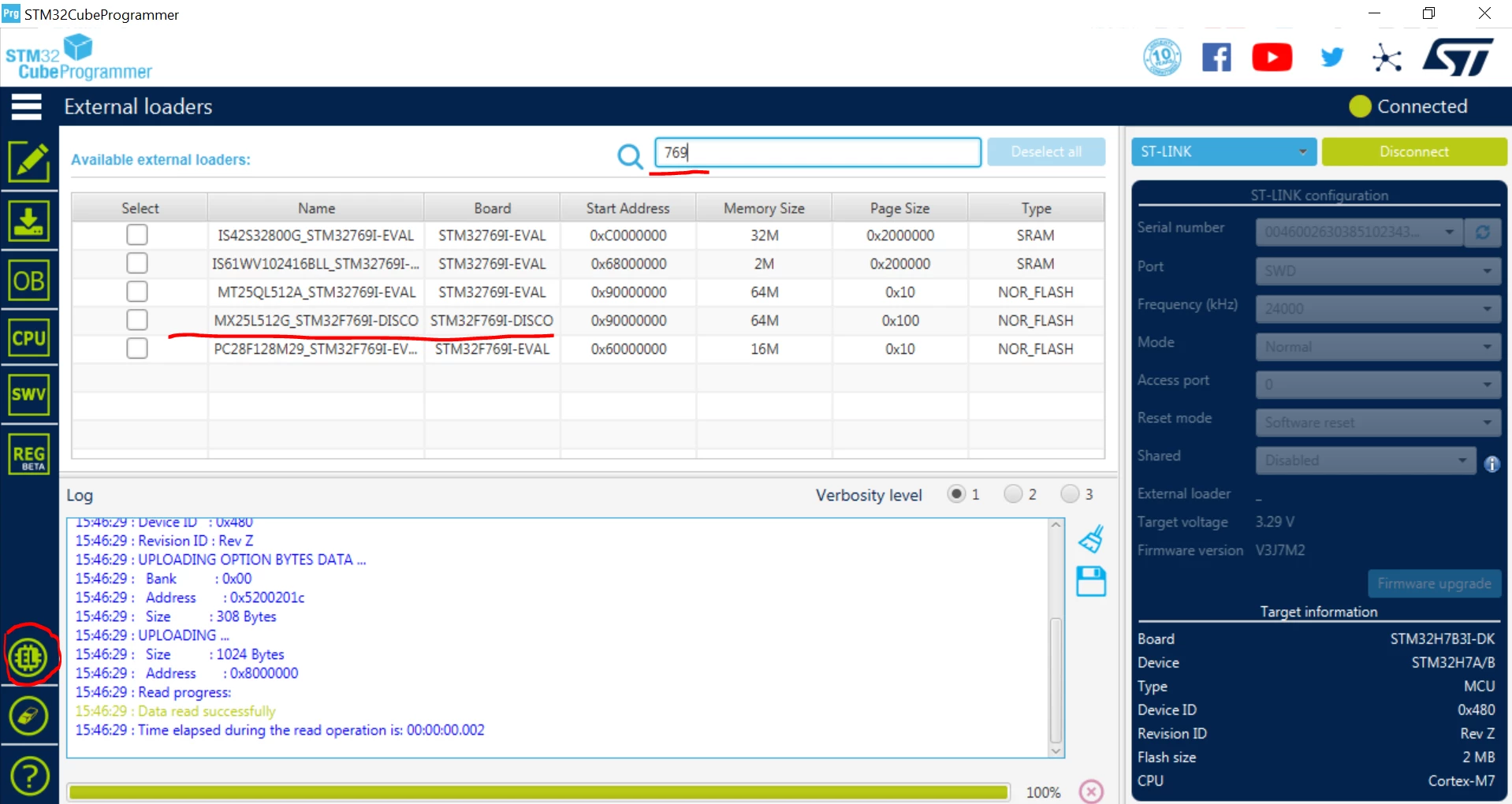

/Romain
