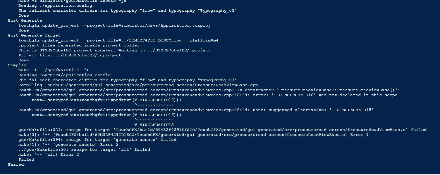

What is the reason for this error? How can I fix.

What version of TouchGFX are you using ? From the log you can see that the issue comes from the missing SINGLEUSE_ID16. If you go to the Text View in TouchGFX Designer you will be able to see all the texts you are using. You can also see them by going to the TouchGFX/assets/text folder and opening the excel sheet. Is the SINGLEUSE_ID16 here ? Look at the Single Use tab and see if that ID16 correspond to anything. If not then maybe try to delete and add again that textArea widget (if it is one). Delete the gui_generated folder as well after jsut in case.
Could you maybe share screenshots of your Text View to see how you handle the texts ? Could you also share the excel sheet in the assets folder ?

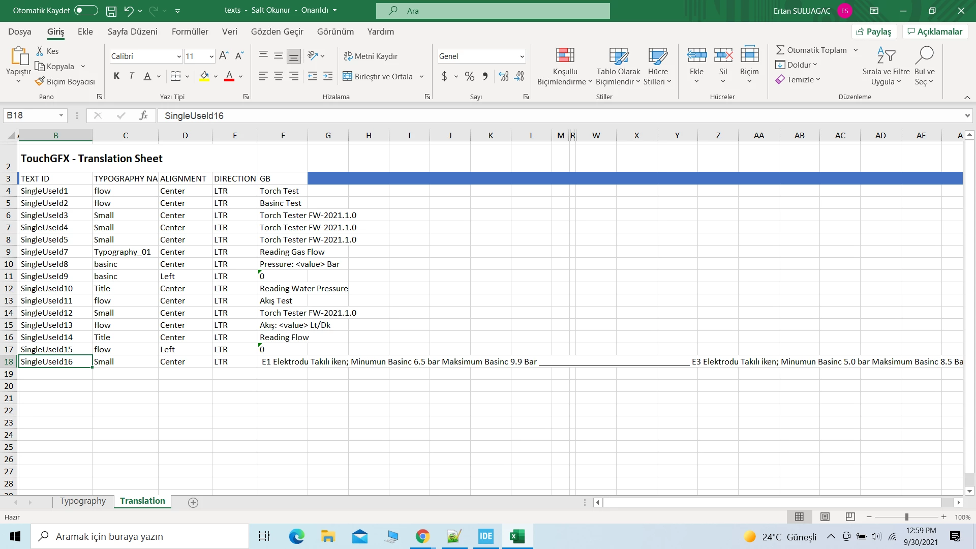

I haven't tried. I added excel.

In the excel sheet you opened you have another tab called "Translation". Could you share a screenshot of that one ? It has the "Text ID" information that needs to be checked.
Were you able to find SINGLEUSE_ID16 in the Text View in TouchGFX Designer ?

Hum... Could you try to delete the /assets, /build, and /generated folders ? Maybe try to delete the TextArea widget "textA" and add it again with another name.
