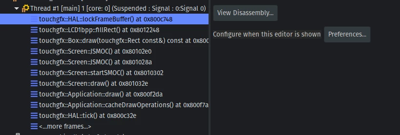

I'm trying to drive an E-INK display via SPI. Have overridden the flushFrameBuffer method, but unfortunately, it never is called. The Main Loop of TouchGFX is blocked.
E-Ink doesn't need to be refreshed at 60Hz. So... I'm lost on how to drive the loop.

I've tried running this function in a timer:
extern "C"
 void TouchGFX_Engine()
		HAL::getInstance()->vSync();
		OSWrappers::signalVSync();
With no effect. Seems to be stuck at lockFrameBuffer()
I'm missing the concept of how the main loop is driven. Any ideas?

Found this thread: TouchGFX with SPI TFT and it appears that this bug has never been fixed.
Richard Lowe
Senior II
February 2, 2021
Confirmed, works with double buffering, does not with a single buffer.
