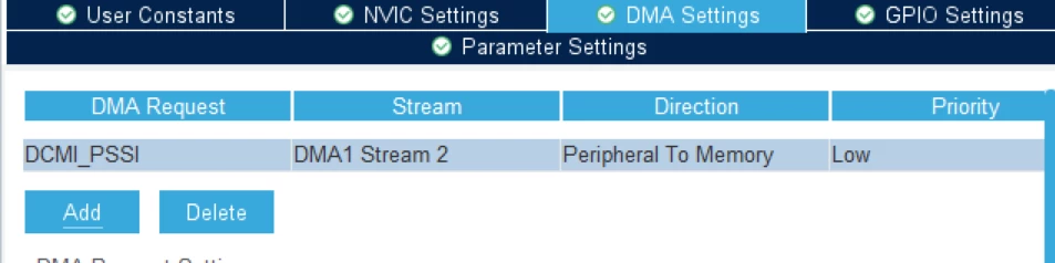

Sara BEN HADJ YAHYA
May 10, 2022 4:01 PM UTC
Hello @Daniel Mårtensson​ ,
Thanks for your feedback,
The only DMA request available for DCMI is DCMI_PSSI.
0693W00000NpiFYQAZ.pngAfter selecting it in CubeMX, The following three lines will be generated in HAL_DCMI_MspInit() function.
A specific comment is added to inform that only one LINK will be useful.
* Several peripheral DMA handle pointers point to the same DMA handle. Be aware that there is only one channel to perform all the requested DMAs. */
 __HAL_LINKDMA(hpssi,DMA_Handle,hdma_dcmi_pssi);
 __HAL_LINKDMA(hpssi,hdmarx,hdma_dcmi_pssi);
 __HAL_LINKDMA(hpssi,hdmatx,hdma_dcmi_pssi);
__HAL_LINKDMA(hpssi,DMA_Handle,hdma_dcmi_pssi) request should be kept and the others should be commented.
Please make sure to comment the unneeded lines each time you re-generate the code.
I hope this helps :smiling_face_with_smiling_eyes:

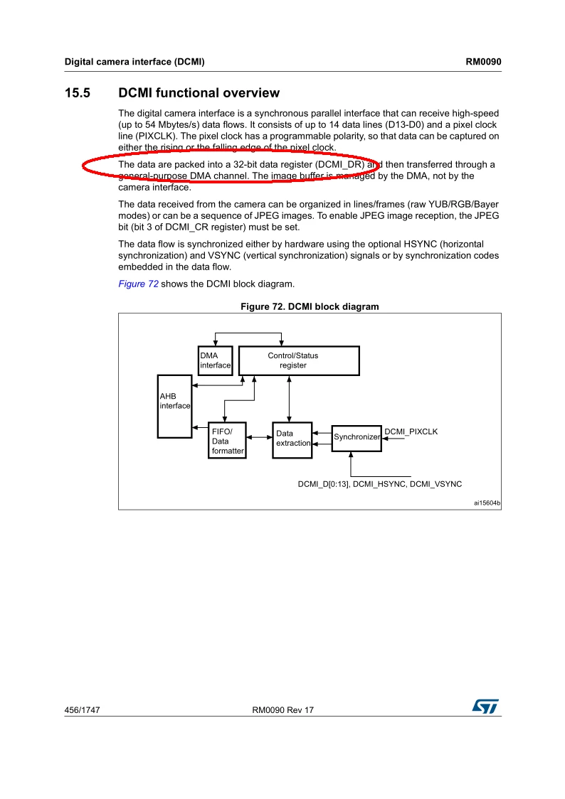

Hello @Sara BEN HADJ YAHYA​
Yes. But how about the rest of the settings such as FIFO settings, memory? Should it be Word, or Half word?

Which STM32?
> FIFO settings,
You mean DMA FIFO? Yes, make the best use of it, this is a high-bandwidth peripheral.
> memory
RAM.
