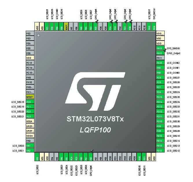

What could make a specific GPIO (PA12 and PA11) on STM32L073V8T6 work when configured as an Input but not work when configured as output?
I have a static LCD, a couple of other GPIOs configured as output and SWD which are all working fine. PA12 does not work when I configure it in output mode and i toggle the pin. I have tried using PA11 also with no success. The .ioc file of my project is attached. Thanks.

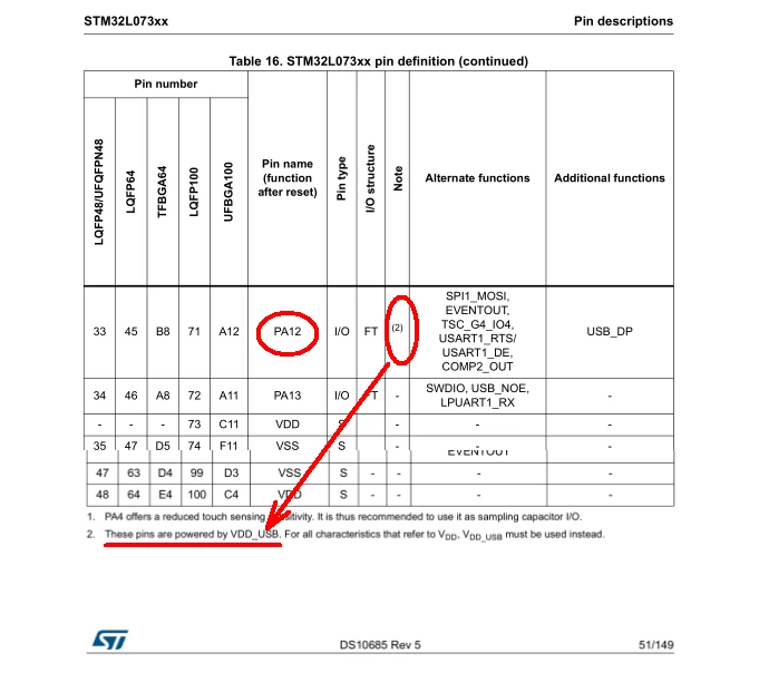

waclawek.jan
waclawek.janBest answer
Feb 8, 2020 11:24 AM UTC
oolor.1
oolor.1Author
Feb 8, 2020 12:10 PM UTC
This was the cause of the problem because on my board VDD_USB was floating because I thought it powered only the USB. :see_no_evil_monkey:
Thanks so much.
