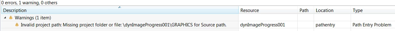

What causes an "Invalid project path: Missing project folder or file: \PROJECT_NAME\GRAPHICS for Source path"
This is a warning listed under the "Problems" tab in STM32CubeIDE (1.1.0). I am seeing some strange behavior and am wondering if this is the cause.

What a nice little evening exchange we're having here on multiple threads. This definitely looks like something is broken in the project generation from CubeMX/IDE. Those "entries" refer to source paths as you can obviously tell, but there's no such thing as a "GRAPHICS" folder. Not sure where that comes from - I'll have to verify tomorrow at the office.
You can remove it by going to project settings. There's a list of source entries probably in the compiler settings.

I am still wondering what causes the warning "Invalid project path: Missing project folder or file: \PROJECT_NAME\GRAPHICS for Source path"

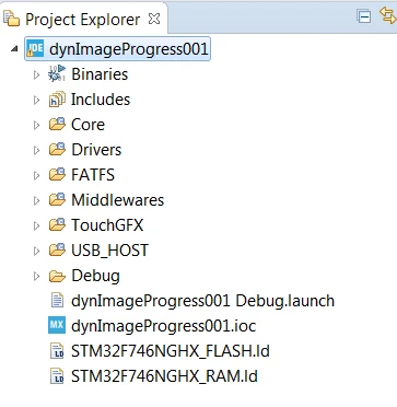

I created a new project in STM32CubeIDE 1.1.0 , and followed the steps to create a simple design in the TouchGFX designer.
It is a simple project with an imageProgress widget in it. Below is what the Project Explorer shows (yes, I did Right Click > Refresh):
Below is the warning:
Should there be a GRAPHICS folder in the project?

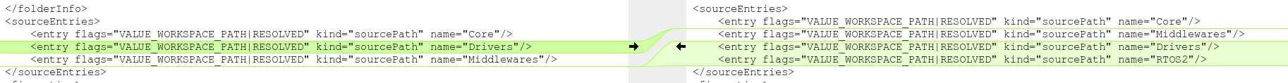

Can you try to inspect the .cproject file or .project file for where this reference is coming from and paste it here? It looks strange.

I have a similar situation for the "RTOS2" folder
The entry with the RTOS folder can be found in the .cproject file. CubeMx is responsible for this.
Simply adding the missing folder from the file manager solves the problem.
Additionally, this folder can be deleted from the file project tree in STM32CubeIDE, which will remove the folder from the file system and from the .cproject file to...
